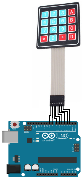

was thinking of something like this, no resisttors just straight hook up. just going to make a 5 * 6 matrix so 11 wires

That will only work if you enable the internal pull-up resistors. See Here.
Yes, they will increse device dissipation when puled low against them. However it will only be to the tune of about 1mW per pin.
