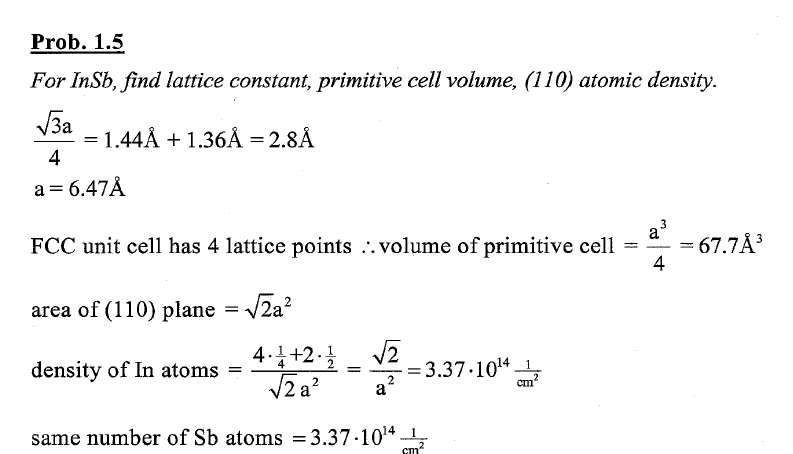

Anyway, how do I find the atomic density of a given plane ? let say (110) ? The formula is atoms/volume ?
Thank you

I am confuse why atomic density the unit is atoms per cubic meter square ?

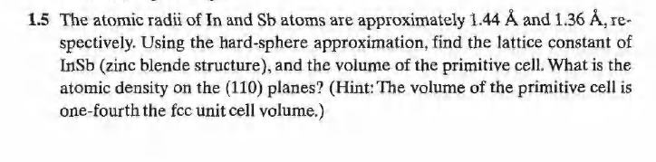

See this question :
Q :
A :
Is that mistake in the solution ?

No, the text is about the number of atoms in a plane. A plane is per definition just 1 atom layer thick, so the density can be given as atoms/cm².

That would be the volumetric atomic density. But the task at hand asked for the atomic density of a specific plane.
