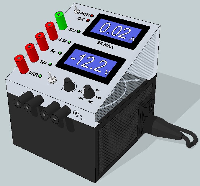

I could use some tips on how to convert PC power supply to bench lab supply.
i have some old 450w power supply, and my vision look something like this:
Convert power supply to max 24V(if it can`t be done since its older one. then 12v is ok) with variable potentiometer and voltmeter lcd.
So that i can use it to test/fried PIC that i manage to program, and for lots of other stuff.
Any ideas would be nice.

I come across this construction.
Just i want to do it without ammeter,only with voltmeter.
and one only ground and positive connector.
and potenciometer for regulation from 2v-24v
cover it with some tape, like sticky carpet, i still got it when i made my subwoofer box.
cover enough not to look like Bender from the futurama but leave holes for vents.

well you would need a boost convertor on either the 12V or 5V rail to boost it to approx. 26 to 28V
Then another adjustable regulator, as an example, say a LM338 ( 5A max ) to vary that 28V between 2 and 24V
ohhh and I wouldn't cover any of it with tape, they need all the ventilation they can get
if you want it to look nice, remove the board, fan and mains connector and mount it in a better looking case
that's to your liking

Maybe i read it wrong but shouldnt i get 24V when i connect something on -12V and +12V?
But i wont get more then 3-4A or I read it wrong or the writer is wrong.
@davenn
Didnt ment all the ventilation to be covered, just metal parts that dont have ventilation points, it has 2 vents,
plus they wont turn on all the time, they should turn on only when needed, more consumption of power or am i wrong?

you are not going to be able to use the +12 and - 12V rails like that as they don't have the same current capability
the -12V rail is usually very low current ... What is the rating for your -12V rail on YOUR PSU ?
and added to that ... most adjustable regulators need at least 2V headroom, which is why I said you need the 26 - 28V into the adj reg.
There may be some switching regulators that will work on 24V in and give ~ 2V - 24V. I haven't checked
something for you to do :)

You can't use -12V and +12V to get +24V and its also low ampere.
Kiwi
have a better suggestion that you buy that DC to DC Converter and you connect it to the +12V with High Ampere capacity ( Yellow Wire ).
