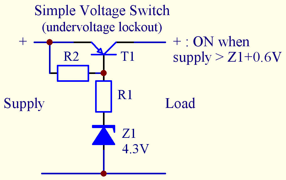

please could you help?
i need a circuit that will block voltage lower than 5V
is there a specific component for this or will i need to build a sub-circuit? [/SIZE][/SIZE]

It's a circuit that runs from a dynamo on a push bike.
Obviously the dynamo will take a second or two to get up to 6+ volts.
But my circuit only works when the voltage is above 5V because the device doesn't accept it at first you have to plug it in when you’re moving which can be a bit dodgy.

the alternator/dynamo is connected to a bridge rectifier so the circuit is effectively DC and i have a regulator keeping it to 5V.
Frequency depends on my speed and that will obviously vary.
after the first stroke the voltage is right and stays right till i stop, speed doesnt have a noticeable impact on the voltage. its when i stop at lights etc. and set off again that the device detects the rise in voltage from 0 to 5V and says this isnt a proper power source.

Aj_s87 there is an elephant in the room on this thread, and it is the device you want to power.
What is it? Do you have a manufacturer and model number? A link to a sales description? A schematic diagram? A detailed description?
Aj_s87
Dec 15, 2012
13
Dec 15, 2012
13
It's for a smart phone. i'll have to upload the schematic later.
When the bike gets going, the voltage builds up. when it gets to 5V the phone starts charging but then a few seconds after an error message appears saying the device isn't compatible. rather than have to reach down and manually flick a switch i'd like it do be able to do it 'automatically' when it reaches +5v. whether its on the AC side or on the rectified side.

Maybe you can try this simple circuit. The transistor should be dimensioned according to your load current. The other components you can easily calculate. R2 is "big" (or not even needed), The zener voltage could be changed a bit to see where it works best (3.9,4.3,4.7V).

Thanks,
Is there a formula for the Resistors?
Is there a specific transistor you would recommend?
Electrobrains
Jan 2, 2012
259
Jan 2, 2012
259
For instance:
T1: BD438
R1: 100 Ohm
R2: not used (or 47k Ohm)
EDIT: Sorry, I was a bit too quick with the suggestion. I did not see that TIP107 is a Darlington! That will not work well.
Better use BD438 (or BD436). Also, you could probably lower R1 to 100 Ohm instead of 470 Ohm.

Would any T0126 transistor work? I'm using multi sim and it doesn't have BD438 or BD436. It does have BF470/BF471
Electrobrains
Jan 2, 2012
259
Jan 2, 2012
259
If you just want to simulate, you could try with almost any normal PNP transistor.
BF470 would show the principle of how it's working, although that transistor has a bit high VCE(sat) and low current (Ic).
I just suggested BD438 because it's cheap, handles high current, has reasonable hFE and quite low VCE(sat) (typical 0.2V).
