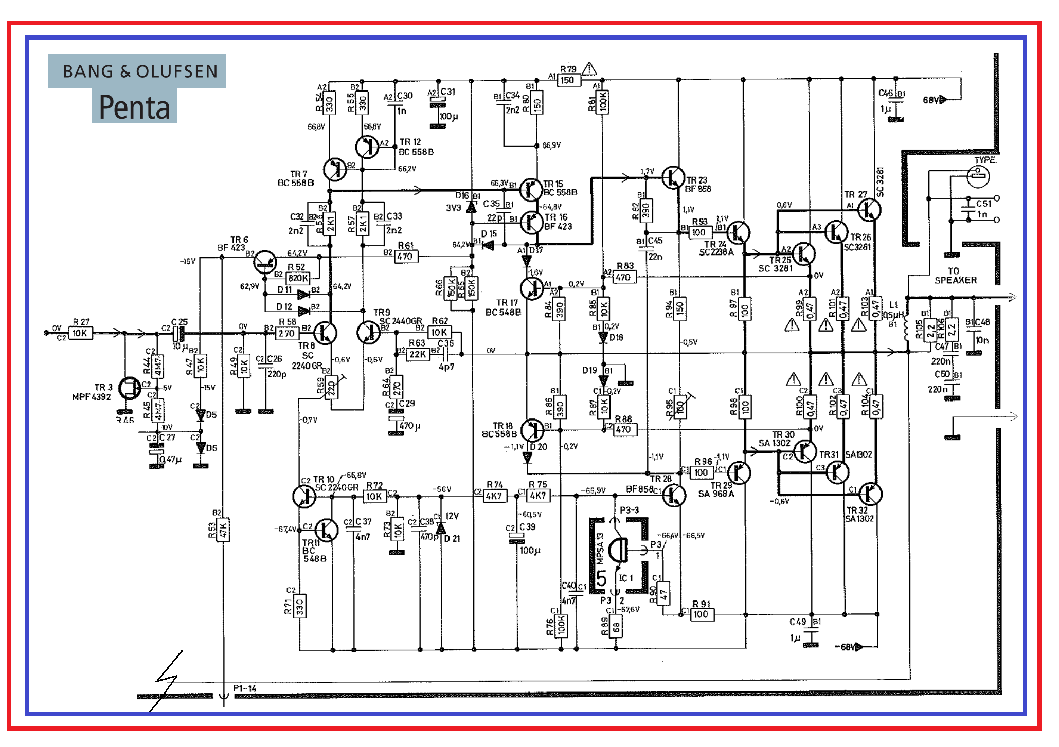

Hi all, just taken on a project - a 150w B&O amplifier from the base of a Penta loudspeaker. The ouput uses 3 cascaded pairs of SC3281 and SA1302.
The unit was blowing the main power fuse - suggesting one or more of these transistors had gone short circuit. With nothing on the resistance measured from the rails (68v-0v -68V) across the emmitter/collector and a 0.47 ohm wire wound resistor was 0.9ohms. Visually theres nothing overheated on the boards - but 2 of the transistors have clearly been replaced in the past as they are a different colour case !
I just found the forum's comments about many replacements being fake. Unfortunately I've already ordered some....from Hong Kong. I'm worried I've just wasted my money.
I understand there are alternatives in the form of the 2SC5200 and the 2SA1943. Are these plug and play or will I need to play with the driver circuitry for the base currents of these.
Any help greatly appreciated. Also any help on how to identify the short circuit - I trained as an electronics engineer over 30 years ago but this is my first foray since then.

On paper, you can replace the 2SC3281/2SA1302 with the 2SC5200/2SA1943.
But you have to realize there is no such thing as plug and play regarding the replacement of output stage power transistors.
In any case the Idle current should be adjusted(even when replacing with the same number Tr.s exactly).
You should also check the drivers and bias transistors.
It is very common that when the powers short/blow they blow as well.
Shorts are identified with an ohm-meter.
When using a DMM better check in "diode" mode.
Do you have the schematics of the output stage?

Well,
The PA final Tr.s are not cascaded they are paralleled.
You should check all the finals(in blue) drivers(in pink).
Test them in "diode mode" B-C ,B-E and C-E that is a total of 6 measurements for each Tr.(3 and 3 in reverse polarity)
If you need help with that post the test results in a table form.
You can start in circuit if something looks suspicious take it out and re-measure.
The power resistors(green) should be check as well (in ohm test).
The pot.(in red) is for setting the idle current.
The pics should be at higher resolution they aren't clear enough.

If the measurements are correct than all the Tr.s are you measured are bad:
RED -shorted C-E .
Blue-open B-E.
Green- somewhere in the middle but also bad.
Have you measured out of circuit?
Need to check the power resistors and also the next bunch in red below:

Have you any good Tr.s to test for reference?
For instance,check on another channel.
Another thing ,
make sure there is no insulating coating on the pads you have checked(just to be on the safe side of the measurements)
That is a very long line of destruction!:eek:
I would start removing them from the finals inwards ,
and test them again outside the board as I go.
Very important !
Make sure you mark each Tr. on the board when you pull it out including direction.
A good idea is to take a photo before you start .

mine did but weirdly no mention of the final driver transistors - such as tr27.
They are all on the above circuit diagram
TR 25, 26, 27 = 2SC3281
TR 30, 31, 32 = 2SA1302
Dave

punkieys17 . . . . . .
Did you actually find fault with D5 and D6, with them being so remote from the typical problem area ?
Or . . . . . after having found so many bad parts in the power audio area, that you are now being fully into the
frenzied . . . . . "off with their heads ". . . . . mode.
Back when you were testing TR12 . . . . do note that it is being shorted B to C to be configured for a thermal compensating diode function for
the base of TR15 of the TR15-16 series pair .
I don't think that there will be problems with TR3 at all.
Its function is as a mute element, if its gate is activated, the Drain to Source short/conduction mutes the incoming audio.
When your care package with ALL of your semis comes in, hold off on installing ANY of your big power output devices, and just test up to the driver stages.
That then lets you see if all is in order and that the frontal circuitry feeding to TR24 and 29 is balancing them out and they will have have very close to zero volts at their common point of their R98 and R99 emitter resistors tieing together.
To be on the safe side, I would even initially be testing with a series 100 watt incandescent lamp in series with the AC line input
Did you find your mentioned :
" only the bf423 and bf858 are going to be hard to source"
I found:
I don't think that you would have to worry about these "past prime time" / or / "not considered for new design" / or / "NLA " devices being
counterfeit units.
http://www.ebay.com/itm/Siemens-BF858-Silicon-NPN-High-Voltage-Power-Transistor-TO-202-/271071597359
http://www.ebay.co.uk/itm/1-PC-BF423-PNP-Silicium-Low-Power-LF-Transistor-CS-TO92-/221706505211
( Limit, 6 to a customer from out of that pile)
Thasssit . . . . . .
Addenda after seeing just above:
The TR24 and 29 are the "final" DRIVER transistors while the
TR25 and 30
TR26 and 31
TR27 and 32
are being the complementary NPN / PNP power output transistors
73's de Edd

So stripped out the semis back to TR3 (MPF4392). ALL THE SEMIS WERE BLOWN ! Would like to know how to test TR3 - not sure if the test meter on diode setting will work on this type (n-channel JFET). Once I know the fate of TR3 I will get the replacements ordered. Once D5 & D6 are replaced I'm tepted to energise the 15V lines to see if the first stages are working. I am sure all the supply rails (15V & 68V) are workings as they should.
Testing a JFET:
Your T3 is an N-channel JFET.
Test it like you test an NPN-BJT in diode test mode.
i.e Base replaced by Gate .
you should get Froward diodes when gate is + lead (G-D,G-S).
and Backwards diodes when gate is - lead (G-D,G-S).
The only difference between JFET and BJT is :
same resistance(relatively low) between D-S and S-D
while with C-E or E-C resistance is "infinity".
One important test to perform:
Tets resistance between output (L1) to GND and ±68V rails
Another thing is testing all diodes in the P.A stage ,
including Zeners (D16,D21),
and all "power resistors"/low resistance resistors(R89-R106).
I would also replace ,or at least Deoxit the trimmers R59,R95.
Did you check "IC1" the Dralington transistor?
