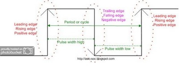

A rising edge is the transition from low to high. It is also named positive edge
A falling edge is the high to low transition. It is also known as the negative edge
A leading edge is an event that is triggered on the front edge of a pulse
A trailing edge is the opposite of a leading edge. It is triggered on the back edge of a pulse.
I don't understand the difference between Rising Edge Vs Leading Edge, are they different? and is the falling edge different than the trailing edge?
Rleo6965
Jan 22, 2012
585
Jan 22, 2012
585
This might help.
Harald Kapp
Nov 17, 2011
14,317
Nov 17, 2011
14,317
If you have a continuous clock signal, the definition of leading edge and trailing edge is more or less arbitrary. It is just a custom to mark the low-high transistion as the leading edge since this is the edge where circuits are many clock sensitive
If you have a signal that does not run a continuous clock but is normally idle, followed by one or more clock pulses, the definition of leading and trailing edge also depends on the logic state of the signal when idle.
1) Assume your signal is Low in the idle state. Then a clock pulse starts with a low-high transistion from the idle state (remember: low). In this case the leading edge would be the low-high transistion (imagine standing on the signal line and watching the edge of the clock rolling right up to you: the first sign of the clock is the L-H transistion leading the pulse towards you).
2) Assume your signal is High in the idle state. Then a clock pulse starts with a high-low transistion from the idle state (remember: high). In this case the leading edge would be the high-low transistion (imagine standing on the signal line and watching the edge of the clock rolling right up to you: the first sign of the clock is the H-L transistion leading the pulse towards you).
You should always keep in mind the exact circumstances of the circuit and the signals within the circuit when dealing with such matters. There is no general truth. Rleo's signature states this in a rather precise way.

The leading edge may be a rising edge or a falling edge.
If the signal is normally high and the pulse is a short duration at a low voltage, then the leading edge is a falling edge.
If the signal is normally low and the pulse is a short duration at a high voltage, then the leading edge is a rising edge and the trailing edge is a falling edge.
It all depends of what you define as the start and the end. Whatever way the signal goes at the start, that's the leading edge and the same for the trailing edge.
