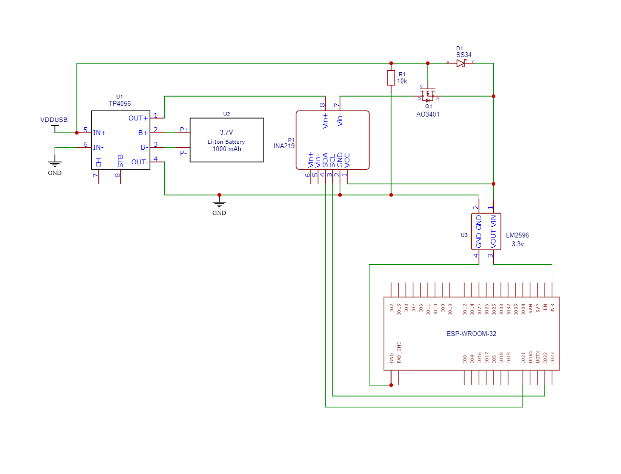

I want to create a project where I can charge my Li-Po Battery (3.7v 1000mah) with a Load Sharing and detect when its low energy measuring its voltage with a current sensor INA219 in a ESP32 microcontroller.
I'm using a step down of 3.3v (LM2596) to power the ESP32, but also in doubt if should connect it directly in the 5v pin.
I'm really new and create this schematic and want to know how I should pass the battery to the sensor and measure its voltage level, its correct this way?
Sure if you want to blow up the LiPo battery that's how I would connect it. Don't play with fire.

The load sharing circuit allows the USB power to run the ESP8266 or ESP32 when it is connected. That allows the battery charging to proceed to termination independently. You don't want the charger to provide power to the ESP.

Thank you for the reply.
If you would put a current sensor in this schematic to measure the voltage of the battery to the ESP32, how would you do it?
Thinking in using a INA219 module like this:
This doesn't work. A current sensor measures current, as the name implies, not voltage.
The ESP32 has 2 integrated ADCs. These can measure up to 2.45 V. Use a resistive voltage divider zu divide the battery voltage e.g. by 2, then measure this voltage directly with one of the ESP32's ADCs. No need for an external converter module.
You are correct, its because the INA219 its a current and voltage sensor, but I only mentioned it as a current sensor, my bad.
I'm using a battery charger with load sharing of a 5v USB, looking into my drawn, it will convert both to 5v with a MT3608 step up (not to 3.3v, it was not a good way), so to not measure the 5v, but the battery 3.7v, it will have two power inputs (?)
Check the battery charger module. Typically BAT- and GND are the same. Then you only need to divide BAT+ and measure from there to GND.
