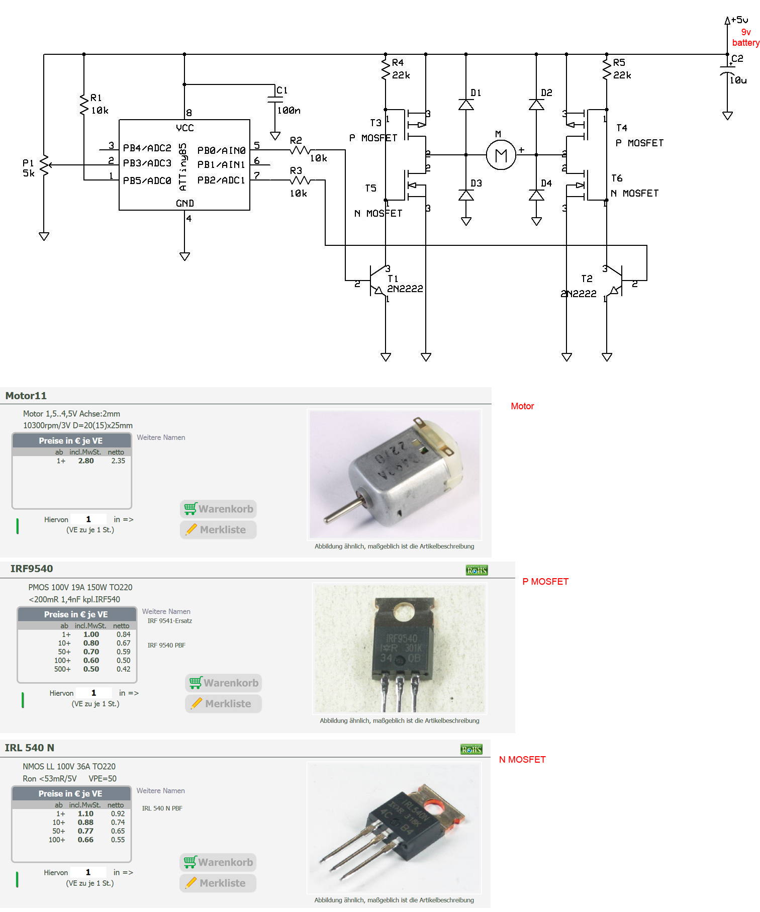

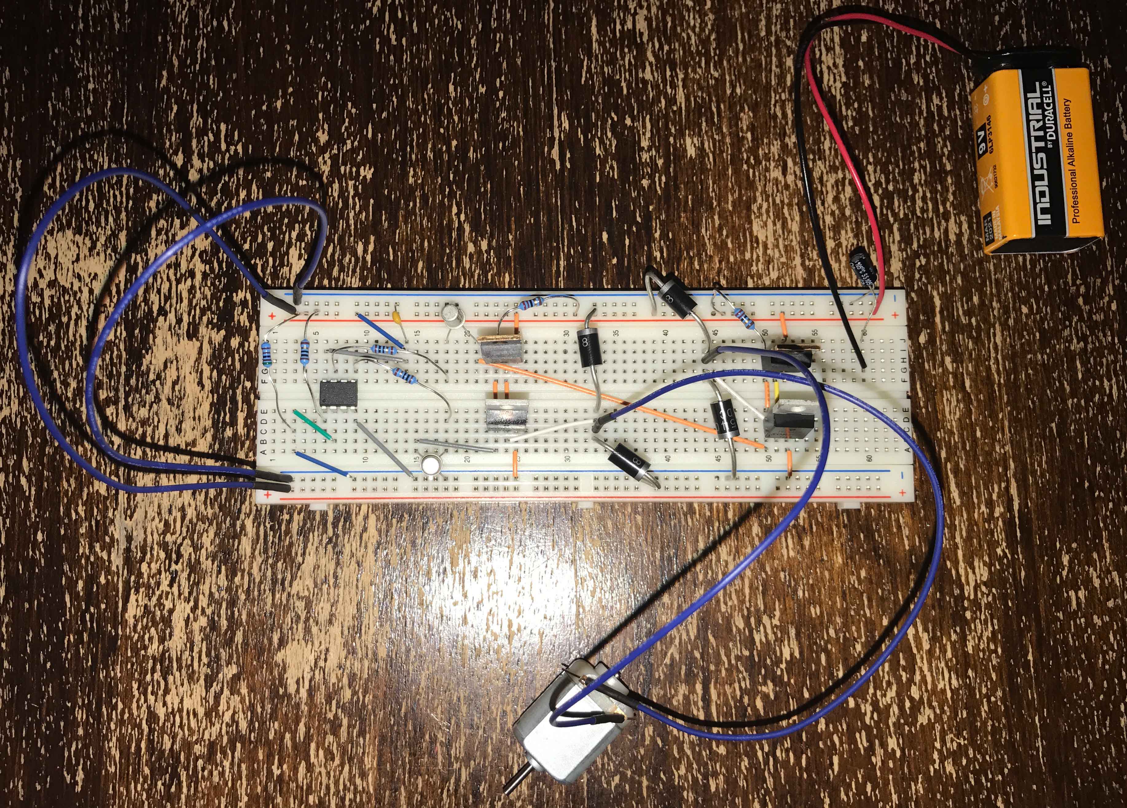

This is the breadboard I built (I think quite faithfully to what you suggested):
I was a bit of a fool in my original description, I said 5 volt power source - I meant 9V.
Here is your schematic again with info about the motor and the Mosfets that I used:
Can you see where I am going wrong (if it isn't the coding - which I am sure is the problem)? And if you can, could you help me and tell me how to fix it?
Many, many thanks in advance!

First of all there is a very big problem. The supply voltage. For the Attiny85 the absolute maximum supply voltage is around 6 V. It is highly possible that you have destroyed the microcontroller. A not so big problem is the motors. They are rated for 1.5 - 4.5 V and you have applied 9 V. Why?
You can fix these two problems by usng a 5V supply (the easiest way) or separating the microcontroller power by inserting a 5V regulator (cut the power line just to the left of the R4 and insert a regulator (7805 or similar). The latter solution requires that you change the motor and use a 9V type.
You can omit the flyback diodes because the MOSFETs you are using have them built in.

First of all there is a very big problem. The supply voltage... you have applied 9 V. Why?

Attiny85 is interesting. I have connected 12V by mistake but the chips keeps working now. :)
One mistake in your code is:
not "delay(20000);"
but "delay(y);"
Another one is very important: You MUST declare the two ports as outputs.
pinMode(0, OUTPUT);
pinMode(2, OUTPUT);
Usually the two variables (x and y) should be declared before setup() but this doesn't prevent your code from running.
I would first check the hardware. That means, without the microcontroller in place, use jumper wires to connect the resistors at the bases of the driver transistors to +5V (one at a time) and check the motor is running. If not, there is a wiring problem.
So please be sure that the motor driver is connected properly. Then proceed to the microcontroller and the code.

It is unfortunately still not working.
I'm not surprised ... you have wiring errors on your board .... you haven't followed the schematic
1) for a start ..... the negative of the battery ( black wire) isn't even connected to the circuit .... it should be in the top blue negative rail of the board
2) the capacitor in the top right corner is wired incorrectly ..... it should be between the blue rail and the red rail
3) your diodes are not correctly wired .... the top 2 are, the bottom 2 are not
4) You don't even have the P1 trim pot in there
there's 4 obvious mistakes with just a quick glance ;)
Dave
