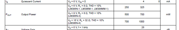

Hi Bertus,
Thank you for the reply. I will be connecting with a small speaker I believe. Do you think I will need a much bigger speaker for achieving enough vibration needed for the Chladni Plate?
I am a bit confused here as well in this video.
. In the beginning, he said it's an 8ohm 15W speaker. How would LM386 surviving in his video?
Also, I think in my case, the input will be the signal from function generator, right?
This means only that the speaker can work at 15 W. It does not imply that the LM386 really delivered these 15 W. I'm not going to watch the video, but assuming a supply voltage of 8 V the power output of the LM386 to an 8 Ohm speaker is likely < 1 W.
The BIG difference between the output of a function generator and an amplifier is the internal resistance/impedance:
The function generator has typically 50 Ohm impedance. With an 8 Ohm load it creates a voltage divider 8/58 =0.138. Most of the output voltage creates power dissipation across the internal impedance instead of providing power to the speaker.
An amplifier has a low output impedance << 1 Ohm. With an 8 Ohm load it creates a voltage divider > 8/9. Most of the output voltage is available to drive the speaker.
