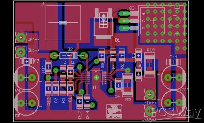

Go with a constant-voltage driver rated for 24V. It should have enough wattage to handle your setup.
  • Choose a driver with at least 20-30% overhead, so a 24V driver rated for 250W is ideal. Here is a constant current LED driver design that you may take a look at:
