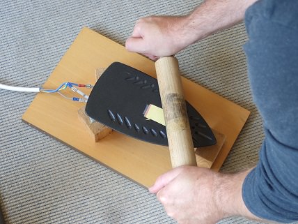

Have you considered toner transfer?
Yep, as mentioned in my OP, "most inkjet methods i've seen are too fiddly, finicky, and/or sloppy)."
A UV box or laser cutter seems superior to messing around with magazine pages and a laminator or clothes iron. No?

You need to do more research. Toner transfer does not involve an inkjet printer.
i've only seen toner-transfer methods involving either an inkjet printer or a laser printer, plus a laminator or clothes iron.
https://www.instructables.com/id/Cheap-and-Easy-Toner-Transfer-for-PCB-Making/
https://hackaday.com/2016/09/12/take-your-pcbs-from-good-to-great-toner-transfer/
(what i don't want to do)

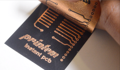

method of interest:
The technique prints the PCB pattern onto a sheet of Printem film which is then exposed to light for around 30 seconds and then the top layer is peeled back to reveal the finished PCB, that’s it!
Not commercially available yet.
http://printem.io/
https://hackaday.io/project/13270-printem-instant-printed-circuit-boards

I use the '
Seems much cleaner and nicer than messing with a laser printer, ripped-out magazine pages, and a clothes iron.
I use the 'shiny' backing paper left over from adhesive stickers (the backing) - laser toner can almost (in fact quite easily) be wiped off with the finger such is its non-adhesive quality. It retains enough stickiness to get the toner where it's needed though.
And I then use a simple laminating machine (used to laminate paper in plastic) to apply the heat. This process has worked flawlessly for me for a number of years, is cheap, repeatable and clean.
