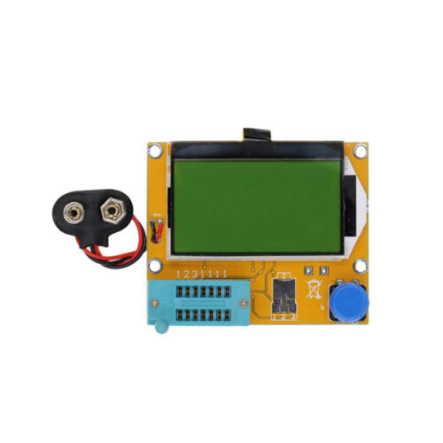

I have one similar to this one.
Not a precision instrument, but a nice gimmick to identify a range of components.
I'll have to admit, however, that I never used it on inductors. The ad states 0.01 mH ... 20 H which is good if the instrument holds up to the promise.
Hi H,
I've tried the cheaper ones, and they do work for the price, but I think I will look for one a bit more in the hope that it's better.
Thanks, C

can you suggest one app £50-100, please?
Here's one I swear by.....
They are so good I have three of them (well, accidentally ordered too many!) but they have good reviews across the internet and at that price simply can't be beaten.
Hi K,
This looks like the one shown earler.
Thanks I'll consider it.
