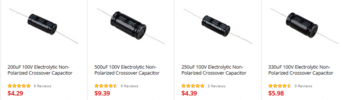

Likely no adjustment anywhere.
The only thing I can think of is to put a large non-polarized capacitor (for example, two electrolytics back-to-back) in series with the speaker leads.
Start with about 500µF and go down from there to reduce the bass.

The capacitors can also be non-polarized speaker crossover capacitors such as these from Parts Express:
