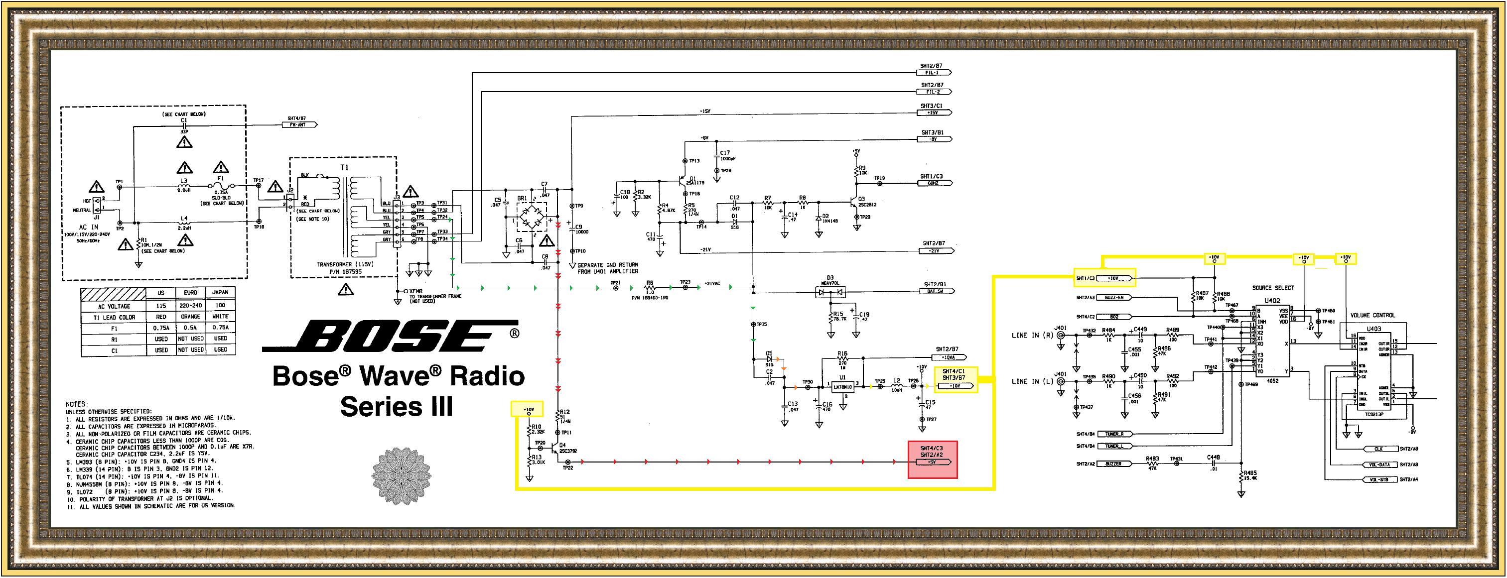

Hello,
Can anyone help with a schematic for the main board for this Bose system please?
It was purchased in 2010 and I have serial number if anyone can help.
I am trying to repair for an elderly neighbour but struggling.
I have scoured the net with no joy.
Many thanks,
Roger

Thanks for input Dave.
There is no model number on the unit or the product manual.
The manual is titled Wave Music System.
The serial number is:- 044413391380029AC
It is a CD and AM/FM tuner with the Bose curved front and output power IC is TDA 7376B
At least 3 power rails but don't know what they should be, not regulators, transistor regulated.
All powers up but no supply to 2 off 4052 analog mux de-mux ic's.
Tried to trace out board but tight and I struggled, hence request for circuit diagram.
Bose gave me link to product info not circuit diagram so struggling.
Do you know anyone who may have access to circuit diagram please?
Thanks for the reply,
Rog

From what has been told to me by your post, see if this info fits your unit.
Also I can differentiate even further, by knowing if your back up battery is using 3 cells or a 9 V battery.
The unit is using a conventional no frills power transformer that generates a basic 15VDC main supply from the BLUE transformer winding, That divides on down to a 5V logic supply BUT is being interlocked with having a +10VDC supply presence.
The 10 VDC supply is derived from the YELLOW transformer winding, as it initially passes as AC down the (GREEN ARROW PATH) until it reaches the DC rectifier diode D5 and transitions out of it as a DC supply . . . . (ORANGE ARROW PATH ) ..
That supply then feeds into the U1 3 term regulator with its 10VDC output as the (YELLOW ARROW PATH ) .
Stop . . . . for an aside observation . . .
That +10VDC supply is also fed aside to initiate the creatig of a +5VDC supply.
It originates at the FWB circuitry of the transformers BLUE winding as a +15 VDC supply and travels down the (DOUBLE RED ARROW PATH) until reaching the collector of pass transistor Q4's collector.
NOTHING happens until your 10VDC supply has come up and created a voltage to divide down at R10 / R13 junction and then having a passage of 5VDC at the emittter of Q4, then its across and down the RED ARROW line to be the switched +5VDC supply leg.
START . . . . . back on the (YELLOW ARROW PATH ) to proceed on the supply path.
Now you mentioned the U402 . . . 4052 signal MUX / selector, so I added it on at the far right side of the schema.
You can then see the +10VDC YELLOW supply feeds of those two CMOS based devices.
Come back, if this info is not in agreement with your unit or for further queries.
Of the 6 WAVE units within our " clan " only one has required service, in the respect of it needing a new AUDIO output POWER AMP I.C. , due to its randomly going off like a LOUD firecracker.
Other supplies are being a minus 21V and minus 5 from D1 from the 21VAC supply line and a dedicated AC winding of ~3-4 VAC from the power transformer GRAY winding for the frontal displays filament.
Thaaaaaaassssssit . . . . .

Hello de Edd,
Firstly many thanks for taking the trouble to pen this reply, much appreciated.
Working through your points this is what I can say:-
I don' see any batteries but... on the main PCB is a 0.3 Farad 5v5 capacitor so maybe doing the back up instead of batteries?
Transformer is different. Billion no 274813-001 rev 0.4
2 windings 5.8v -0 -5.8v and 1.9v- 0- 1.9 v.
No BR1 bridge rectifier 4 discrete diodes
There is no 10 v 3 terminal regulator but I can see 3 TO220 type power transistors in the power supply area :-
2SC1173
2SA473
KSH210
Power output IC is TDA7376 B
Ref number on main PCB is 291619 - 001
What a shame as that is a great schematic!
Have you come across this before if so .........
Many thanks, I look forward to comments.
Best wishes,
Rog

Hi Roger,
I have just gotten a Bose Wave Music System with identical problem - wondering if you have gotten yours fixed?

Hi Roger,
Glad that you've fixed it, and a positive news indeed - it's fixable!
Yes, it different board from Edd's but it's the same as yours - 291619-003. I have read from other sources that TL072 (& 2x 4502 MUX) +5vdv are fed from the few transistors near the transformer: 2SA473, 2Sc1173, and KSH210. However, they are all tested good on my board, providing all the required voltages. So must be an open circuit somewhere in between... And yes, the trace is quite impossible...

Probably too late but for anyone else with the same problem. I had exactly the same fault and it turned out to be a corroded track, it is tiny and runs next to the super cap memory capacitor you will need a good magnifier to spot it.
Great machine and well worth repairing.
