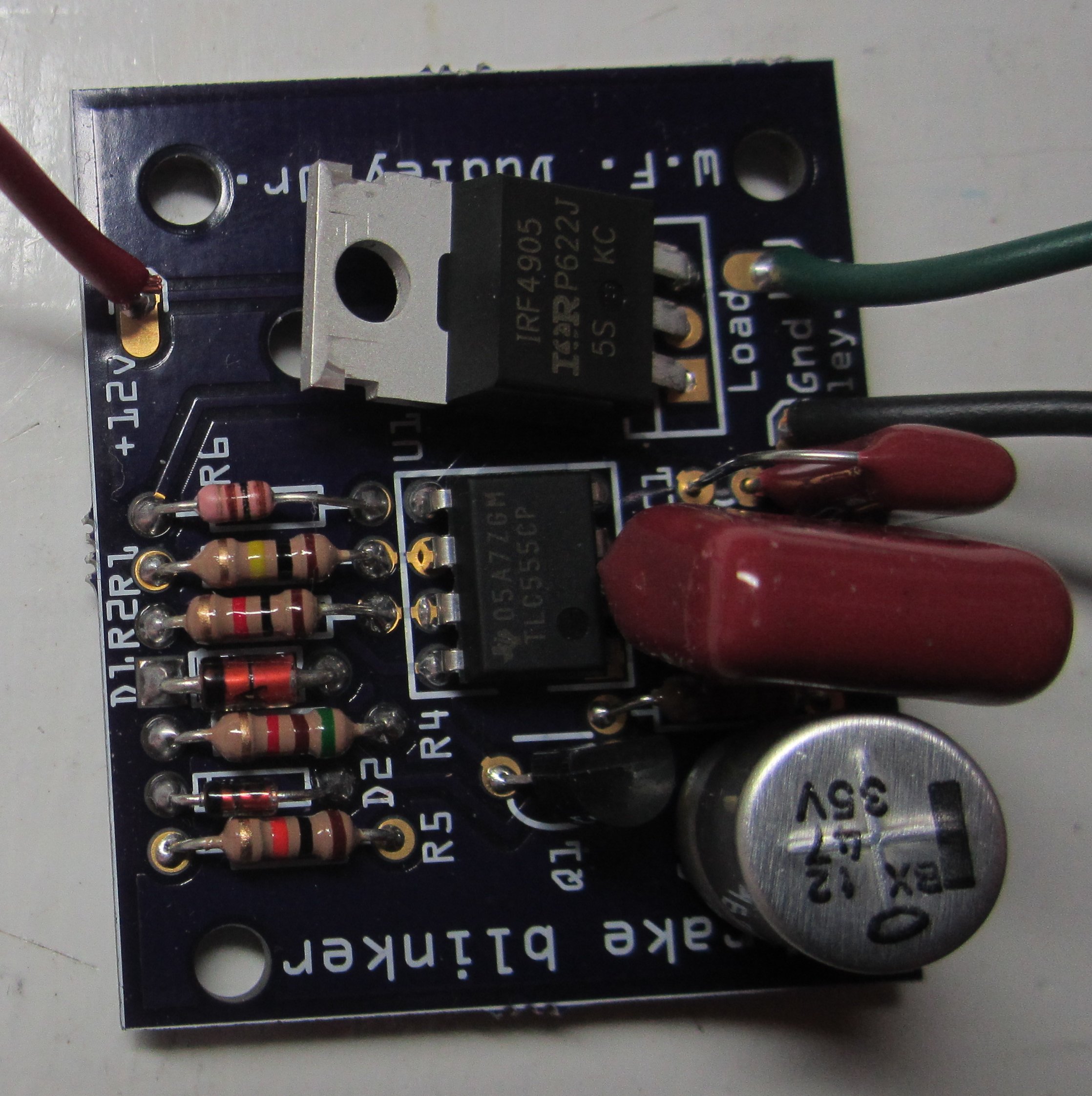

So I'm trying to build a brake light blinker/flasher using the schematics from this guy's website:
http://www.dudley.nu/projects/brake_light_blinker/
I've replicated the best I can (he doesn't provide part#s...just values) on a breadboard, and it works great. I ordered a set of PCBs from OSH Park that he provides files to. I did not modify the PCBs - I just submitted them as they were to OSH Park and I received them a week or 2 later. My problem is that when I tried soldering everything onto one of the circuit boards and testing it out, it doesn't work right. :(
On the breadboard, it does what it should - the 12V DC light bulb blinks several times, then stays on constant (until power is removed of course). But on the PCB version, when you apply power, nothing happens for 2 or 3 seconds, then the light goes on constant. So there's no blinking at all.
When I ordered the components for this circuit from Digikey I ordered a few extras of everything like I always do. So when I soldered everything on onto the PCB I used the same exact components, so I don't get why this isn't working. I was hoping someone could point me in the right direction. I am far from being an EE, so I don't even know where to start.
If it helps, I posted a brief YouTube video of me testing the breadboarded circuit a couple times, then testing the PCB circuit a couple times:
(P.S. I would have contacted the guy who designed this and ask for help, but I can't find any kind of contact form/info/area on his website)
Thanks!

I'm not sure what the cheapist/easiest things to do/check, but I did double-check all the values of the resistors and they check out at the right resistance.
Then I checked temperatures:
Applied power to the breadboard circuit, let it set for about 10 minutes, then took out my cheap IR thermometer. The 555 timer and the mosfet were about in the low 70s (F).
Then I did the same thing to the PCB/problem circuit. Everything was in the mid-high 70s (F). I felt everything by hand also, and nothing was hot. A couple things were warm, but that's it.
Not sure where this leaves me. Would it be the 555 IC?

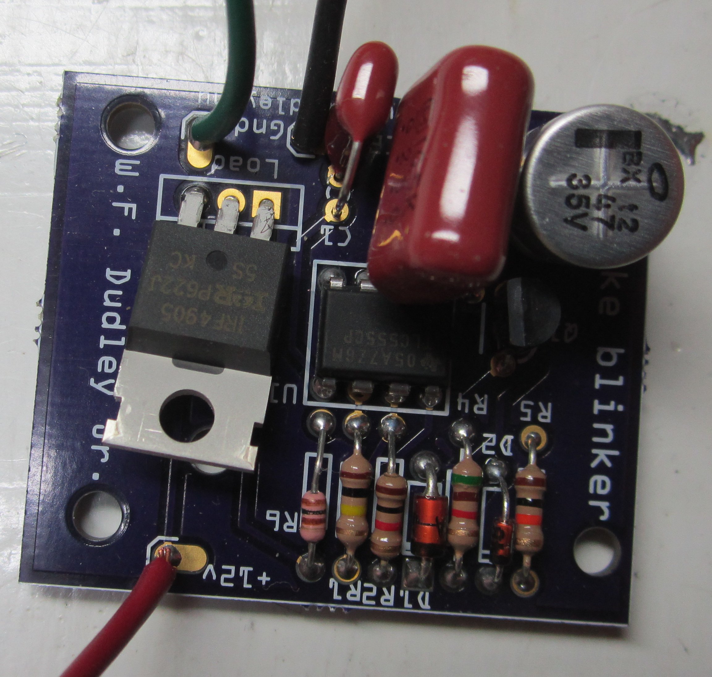

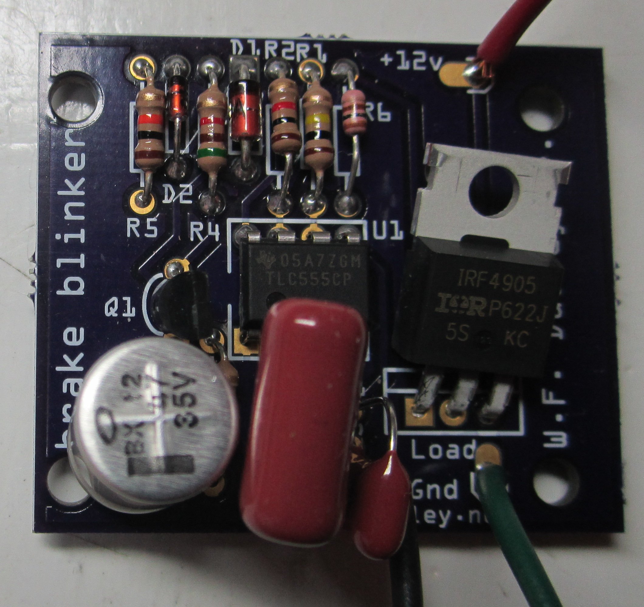

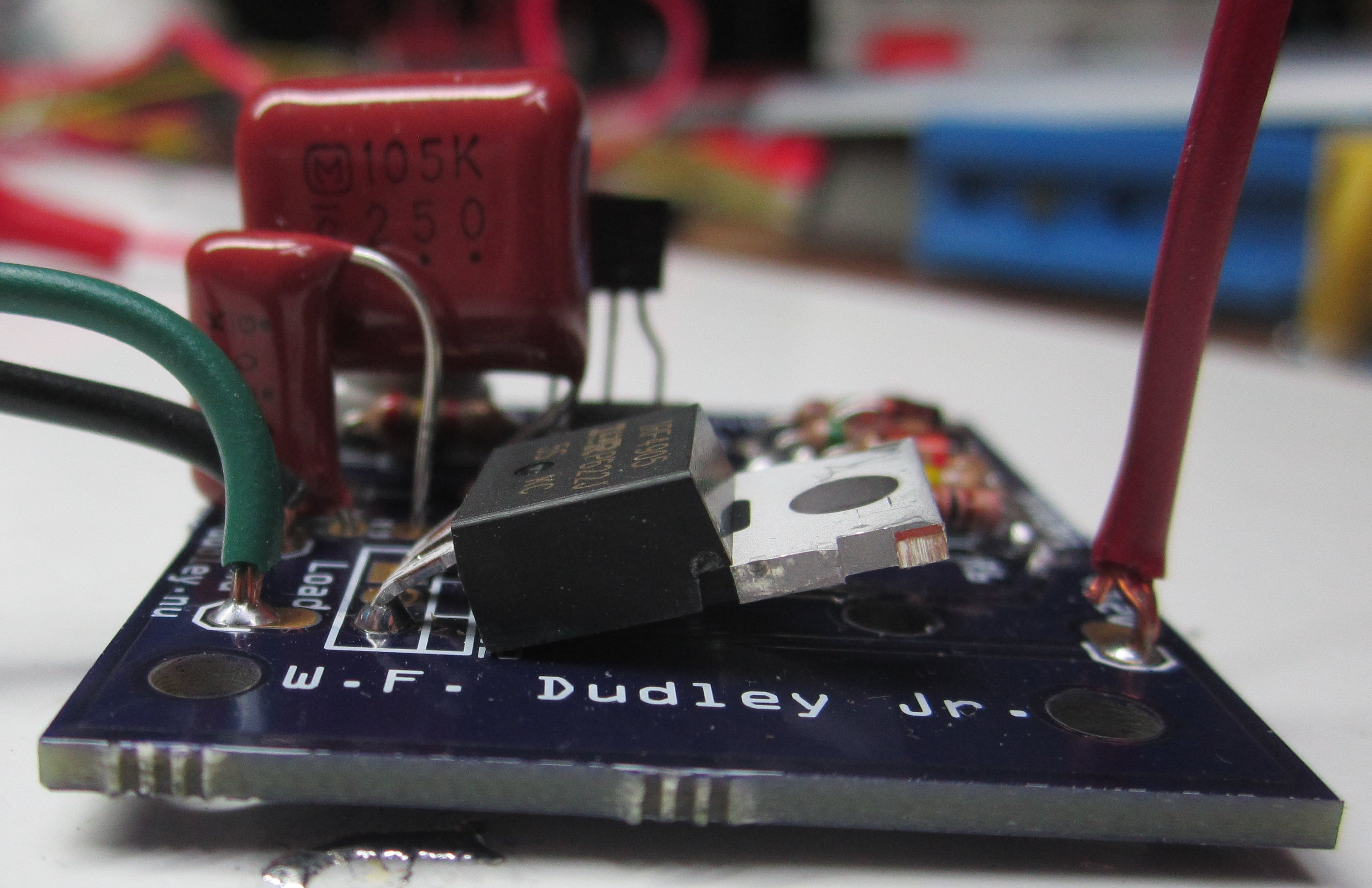

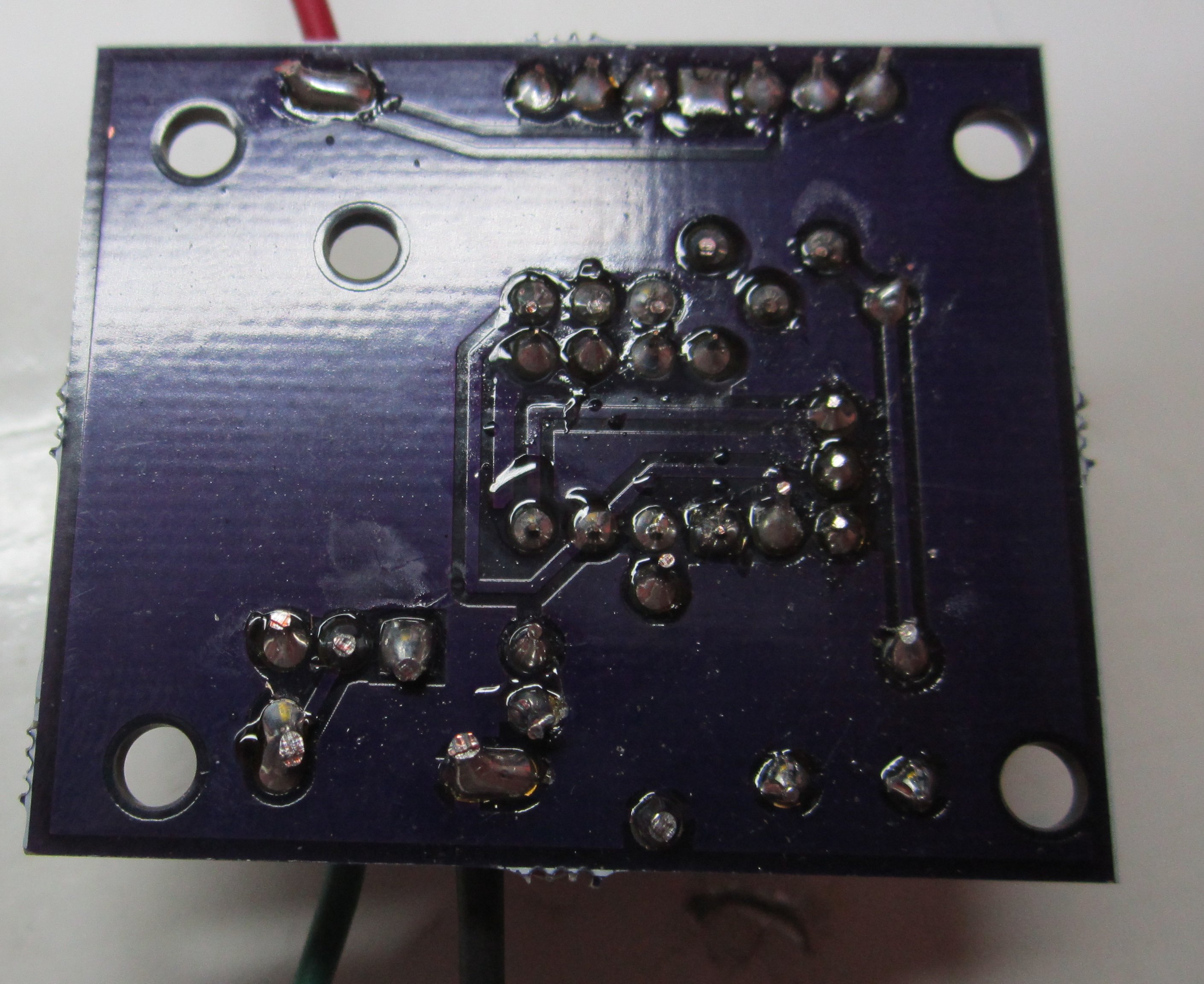

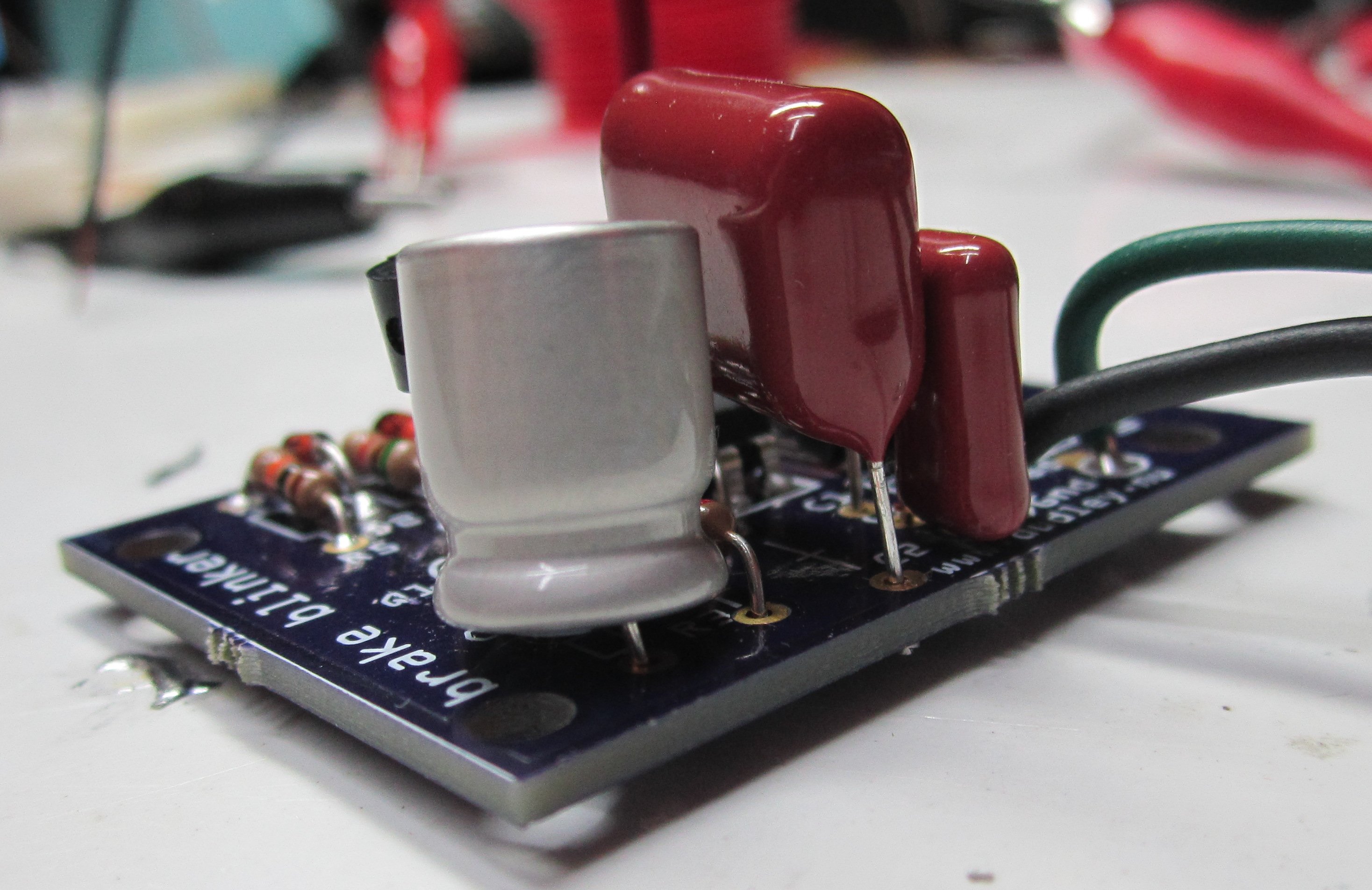

First of all,
I want to thank all of you for all your info/responses. I really appreciate it, and hope my newbiness is not driving anyone nuts.
Ok, so I removed the 'Q1' transistor from the PCB circuit, applied power, and nothing happened. Then I tried removing the 'Q1' transistor from the breadboarded circuit (just to see what would happen), and the bulb just immediately started flashing and never went on solid. Between this difference between breadboard and PCB and from what you guys are saying, it sounds like we're getting somewhere...
But then before I put a new transistor back on the PCB, I added a 20k (closest one I have to 22k) to where the base (middle pin) of the transistor would be, connected to where the 'E' pin on the transistor would go to (ground ). (See photo #14) So I applied power, and nothing happened.
Then I put a new (same one as before and the breadboard's) transistor back on, tested it, and same problem (which I guess was expected).
Not sure if this even helps at all, but another thing I did:
Reversed the polarity on breadboard C3 one way, tested, and the light just constantly flashed. Reversed the polarity on breadboard C3 another way, and the light just immediately turned on solid, didn't change.

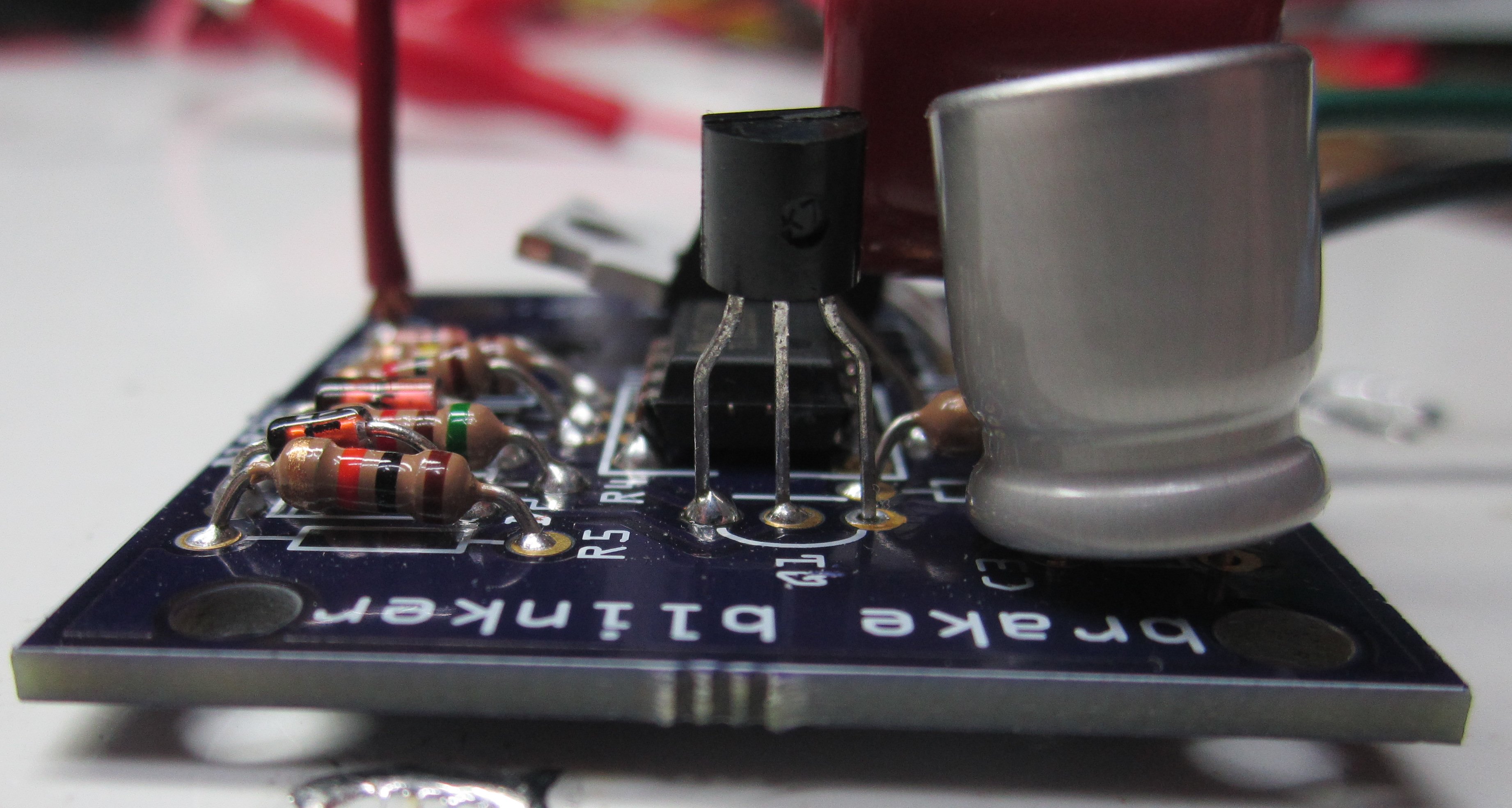

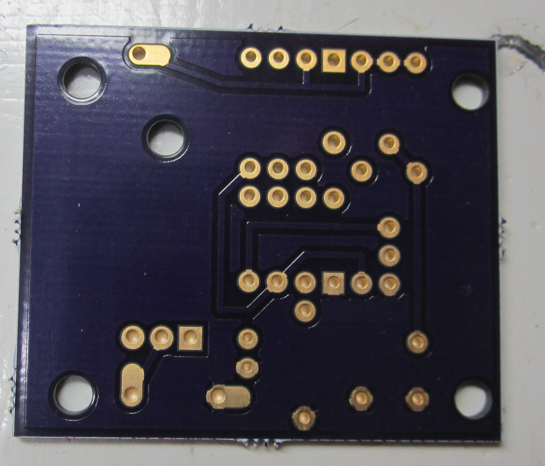

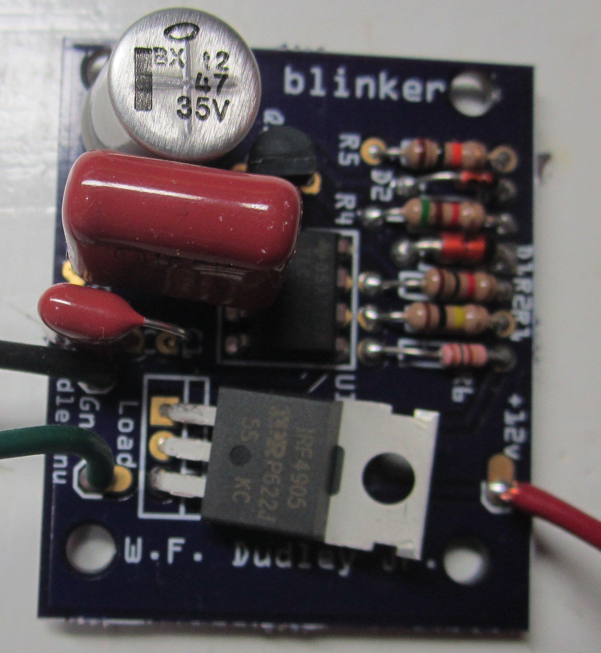

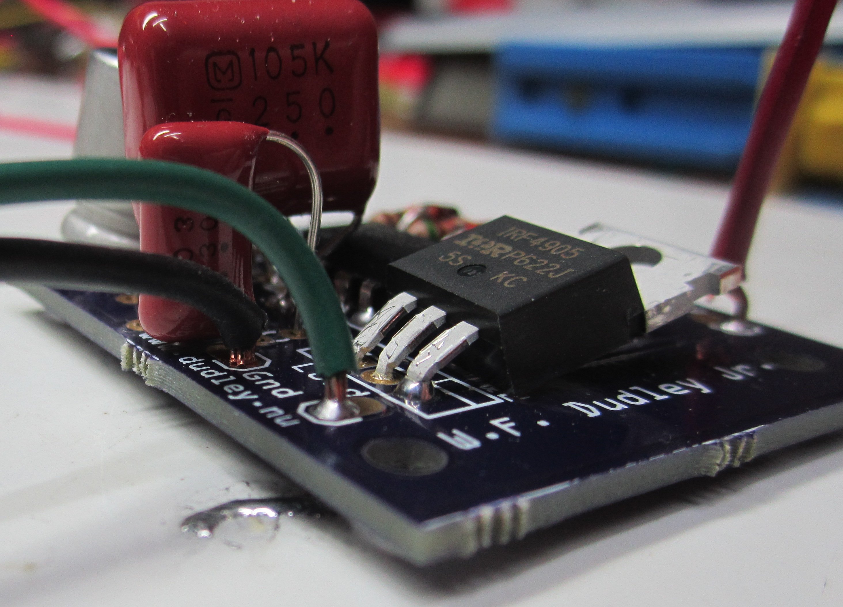

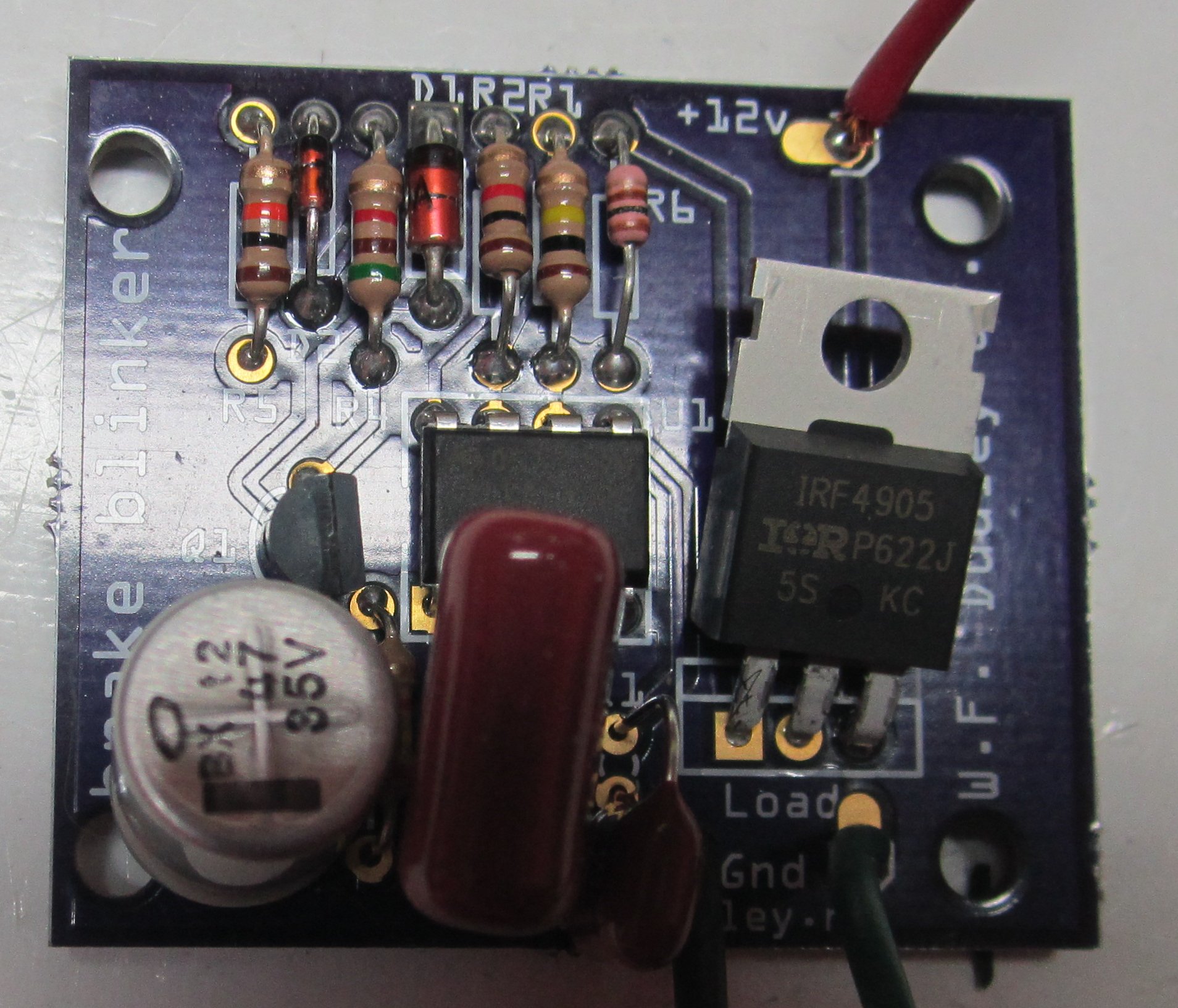

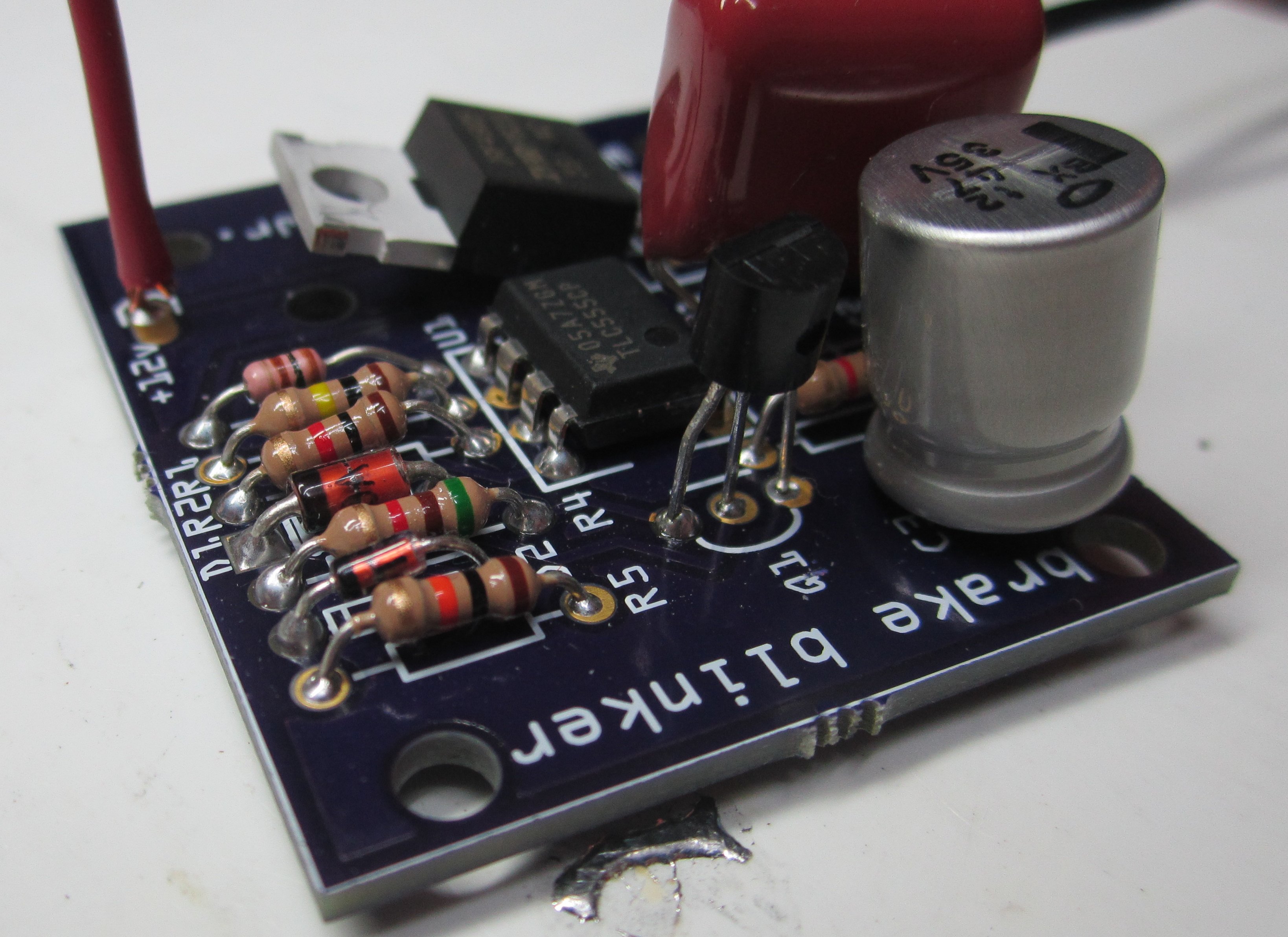

#1 - Bare PCB - back side
#2 - Bare PCB - front side
#3 - Populated PCB - front side
#4 - Populated PCB - front side
#5 - Populated PCB - front side
#6 - Populated PCB - front side
#7 - Populated PCB - front side
#8 - Populated PCB - back side
#9
#10
#11
#12
#13
#14 - Temporary resistor in place of transistor
Well, hopefully this helps you guys help me. I was thinking since I have 3 boards, maybe I should try to make another one and see what happens? I don't know...I'm very tired so maybe I'm not thinking clearly at the moment.
(And thank you everyone again for helping me out)

Images 2 thru 12 do not appear. Did you upload them?
OK, it looks like you linked to them. It is better to upload them and show the thumbnail rather than the full image.
domiflichi
Jun 15, 2016
10
Jun 15, 2016
10
Yeah that's strange - when I was writing the post, all the images were showing just fine.
I'm just going to upload all the images then.

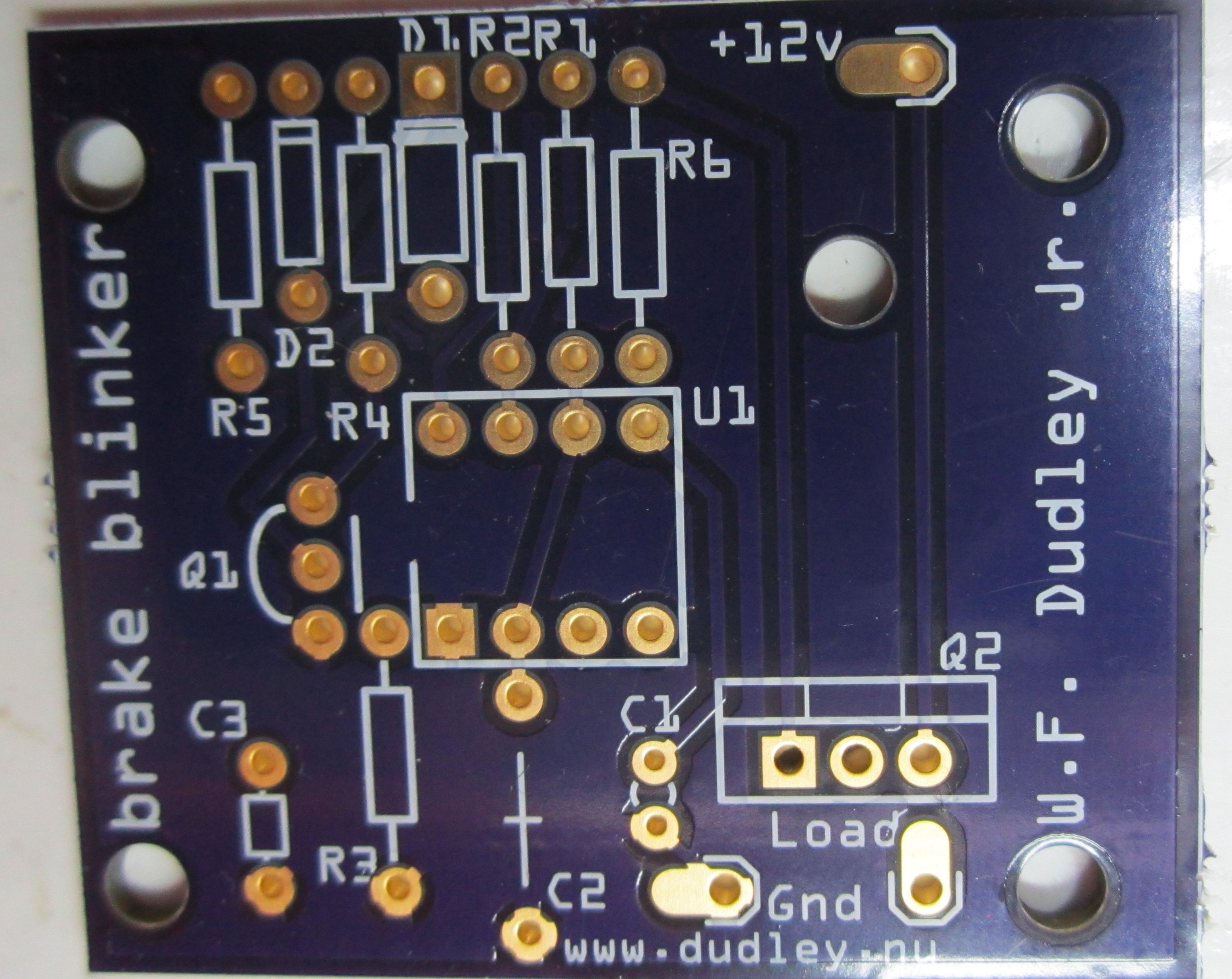

If removing Q1 doesn't make the output flash, but changing C3 does, then I suspect some misconnection.
On an unpopulated board use a multimeter to confirm continuity between points that you expect
The dark solder mask did not make it easy for me to make out the tracks on the small screen of my phone.

Sir domiflichi . . . . .
Ohhhhh . . .Woe is me . . . Nutz to them . . .shoulld they have chosen to use ANY other color than BLACK and Deeeeeeeeep Purple; I could have chroma filtered for acquiring better board to foil differential enhancement.
But I do LUUUUUV that 23 and 59/71ths carrot feed thru and plated holes that they done gaves you !
Now, between the top snippet, confirming power into R2, and the bottom photo covering all of the other interconnect aspects of :
Connecting 12 volts B+ to R2
Then connect R2 to R1 and 555 #7
Then connect R1 to 555 #6
Then they had the boards foil path automatically
doing your jumper path between 555 #6
and 555 #2.
Then 555 #2 connects C2 to ground.
One separate side path, is pin 555 pin 5 To C1 to ground which looks OK.
That constitutes the critical foil path connections, with you only having to confirm my drawn in GREEN marked path.
I still suspect:
ALL of the 6 components, and their connections, on the LEFT of the schema and their connecting into the 555 pin 4 are being good, inclusive of the transistor.
Because you can see their time constant charge up / delay, until the lamp is THEN successfully turned fully on, by their produced change of state at pin 4 of the 555.
Going back to that string of components from 12VDC to R2.. t.. h.. r.. o.. u.. g.. h C2 going to ground, can you confirm the short foil path that is marked in GREEN ?
Otherwise, all looks good on the boards foil paths.
Can you now check that complete flow path with an ohmmeter connected to component leads ?
BOARD vs SCHEMATIC . . . COMPARED
https://s17.postimg.org/b8818efr1/555_Timer_wiring.jpg
