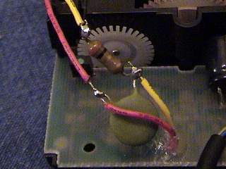

Here is a video that illustrates how the resistance system should work, and below that, I have a resistance motor control board in which exhibits the behavior I describe and I'm trying to troubleshoot to find the faulty board component:
The pin socket at top left is the 5 wire harness that leads to the resistance motor. To the right of that is the 4 wire harness connector that goes from this controller board up to the main console. The IC chips marked are ones that appear to trace to one or both of these pin sockets.
Rear of board above:
I've just tried to identify the components that appear to have obvious traces to the two i/o pin sockets. I'm not certain how to test these components or which I should test first as most obvious.
