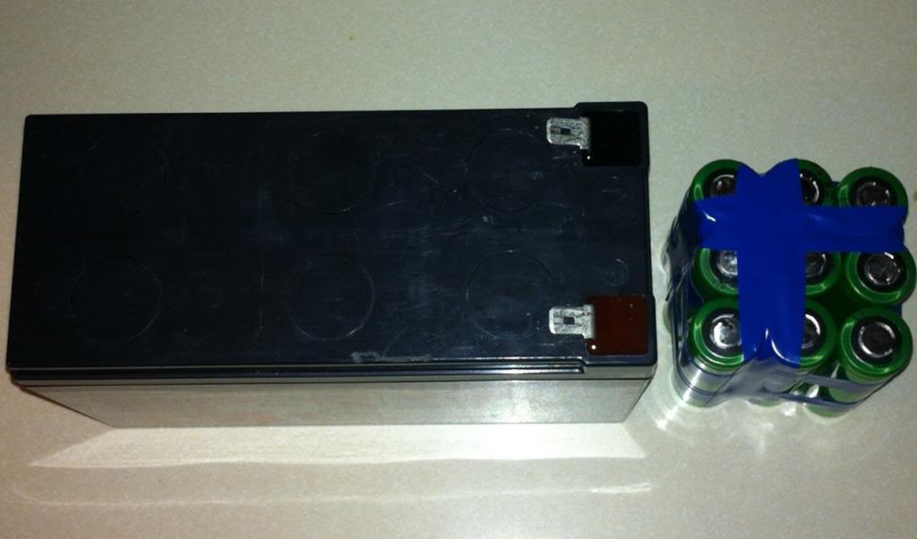

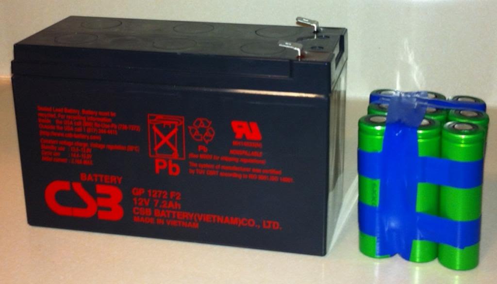

Steve, you must have forgot the highlighted part of the OP.
Here's a quick comparison of similar power capacity SLA and Li-ion batteries. The SLA is a 12V (13.8V fully charged) 7200mAh capacity and the Li-ion pack would be 12.6V fully charged at 6600mAh capacity. The SLA weighs about 4.5 pounds and the Li-ion pack under a pound.

I’m amazed at the size comparison between SLA and Li-ion batteries. Until now I’d assumed that Li-ions’ were common and useful because of their rechargeability, not their power density (if that’s the right term).

Yeah, those are not going to be super efficient use of power, but they will work. I made a battery powered charger for my iPhone the other night when we had a nasty storm that took out power for the night. Still had the wifi router, (battery backup) but my iPhone was dead. Luckily I had some Li-ion 18650s fully charged and sitting. I just used 2 in series to get me up a little over 8 volts and ran them into a 7805 reg, then divided that using resistors to get Vcc, D+, and D- voltages to the correct pins with my USB adapter. I mounted my 7805 on a spare heat sink and I was good to go! And yes, the energy density of Li-ion batteries is really pretty awesome. Much better than just about anything else at the moment I think.
You could do something similar with a Li-ion pack and it will be a heck of a lot less bulky than the items you linked. I think you're talking 15+ pounds for those babies, and the last one you'd need to lug around a battery, because that one doesn't come with a battery, just alligator clips to hook up to one. A Li-ion pack like the one I posted a pic of will get you quite a few charges of your battery.

Re-reading your post, I see that I missed a few points. Your device is probably powered by a single 18650 Li-ion battery @2600mAh. The cells in my pic are 2200mAh each, they are older batteries. There are devices used as power packs for recharging mobile devices, but they are often specific to certain devices and almost universally charge at 5V over USB. You can make your own pretty easily if all you need is 2 wires for charging. It would probably be a good idea to use a 12V pack or SLA and regulate it to 9V like your adapter just to be safe.
