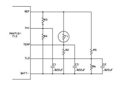

Thermistor
Sorry, another question. I don't know if i can trust the voltage slope to stop this thing before it heats up my batteries, so I want to add temperature control. The datasheet shows 3 thermistors used; 1 reading the batteries, and 2 reading ambient temperature. I want to get rid of the ambient temperature thermistors and replace them with standard resistors to achieve a hard cut-off temperature, regardless of what the temperature is in the room. I did some searching and came up with this diagram:
The author (from this article) says:
First choose a thermistor whose R0 is about 10kOhm, not to exceed 100kOhm (this is required by the inputs of the ‘712). It makes logical sense to pick a value of R2 that is the same resistance as the thermistor’s nominal resistance to make the voltage on the TEMP pin 1V. For illustration I’ll use the muRata NTSA0XV103, a resin coated, twin lead NTC thermistor with nominal resistance of 10k and B=3900. We’ll choose R2 to also be 10k. With these values and desired temperature limits we can determine what voltages to apply to THI and TLO.
Let’s start by finding the voltage THI equivalent to 40 degrees C (313 K). Taking room temperature to be 300 Kelvin, plugging everything in to the equation for R(T) we find that the warm thermistor resistance will be about 5.8k. A simple solution is to match R3 to T1 (when warm) and R4 to R2. Since the warm value of T1 is likely to be something obscure, you can always just match the two divider networks instead by choosing R3/R4 = T1/R2 , so long as the values of the R3 through R6 stay in the 10k to100k range. The low temperature cutoff is calculated in the similar fashion.
I have some 10k thermistors, Epcos part number B57863S0103F040 (datasheet here).
Using the Epcos NTC R/T Calculation tool for that thermistor shows that the nominal resistance at 40 degrees C is around 5.3k ohm. So if i'm going by the author's instructions, R3 would be somewhere around 5.3k ohm and R4 would be 10k ohm (or a combination that adds up to the same amount?). The authors example has him using a 5.8k for R3. However, a couple scentences later he says all the resistors need to be between 10k and 100k. The MAX712 datasheet also says those resistors need to be at least 10k. What am i missing here?
