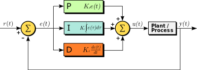

...I want to build a current source that for any load change, it holds a current value by using PID.
This sounds suspiciously like a homework assignment. PID is short for Proportional, Integral, Derivative and is part of automatic control theory. Below is a block diagram of this linear process, extracted from the web page just cited..
The box labeled Plant/Process can be just about anything you can imagine from a soldering iron to a hydro-electric power plant that produces an output, y(t), in response to a control or reference input, r(t). If you ignore (remove) the I and D boxes and examine the P or Proportional box, you can see that the process control input, u(t), is just a linear function of the error signal, e(t), which is the difference between the process output, y(t), and the reference or control input, r(t).
The consequence of this is that e(t) must be some finite, non-zero value, to produce any output, y(t). For any given reference or control input, r(t), there must always be an error, e(t), sufficiently large to produce the output y(t). That means no matter how large the proportional gain, Kp, is there will always be an error between r(t) and y(t). This is commonly called droop because in furnace controls it results in a furnace temperature that is less than the reference or control setting.
To correct for droop, the I box or Integral function is added. This box accumulates (integrates) the error signal as a function of time, applying the integrated result to the Plant/Process input in a direction that will eventually reduce e(t) to zero.
But what if a sudden change of load, or a change in r(t), causes e(t) to change abruptly? The D or Derivative box measures this rate of change and applies a component to u(t) in the opposite direction, thus "anticipating" the change.
So, if we take your proposal of building a PID controller to maintain a constant current across a variable load resistance, then the box labeled Plant/Process will be a voltage-controlled current source, the output y(t) will represent the current output. and r(t) will be the output of your DAC that is used to set the current. So far, so good. There are many things you can put in the Plant/Process box to implement a voltage-controlled current source, such as a MOSFET whose drain is in series with a variable load resistance connected to a voltage supply and whose source is connected through a current-sensing resistor to the other terminal of the voltage supply. A voltage applied between the MOSFET gate and source will control the current, although there may not be a linear relationship.
The derivation of the u(t) signal could be the output of a DAC controlled by a microprocessor, which in essence would emulate the PID functionality as well as the r(t) control or reference input. The microprocessor would need an ADC to derive the y(t) current feedback signal from which e(t) is calculated and then used to compute the PID control signals that constitute the u(t) signal produced by the DAC. Piece of cake, except for stability considerations. There is much math involved in determining whether a PID controller will have a proper response time and be unconditionally stable against perturbations caused by noise and sudden changes in load or control input.
It should be noted that it is impossible to build a constant-current source that will handle any load resistance. There will always be a maximum load resistance that occurs when the compliance voltage of the current source is reached. This will be R = Vcomp/Iconst, where Vcomp is the compliance voltage and Iconst is the constant current output.
