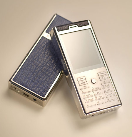

Hello everyone!
I was looking at some luxury and/or "tailor-made" phones, like Bellperre http://www.bellperre.com/ or http://www.vertu.com/en/ and I had an idea of building a custom, one-of-a-kind cell phone. I have a background in jewelry so I know that luxury items have a huge mark up, and that materials by themselves (even gold or gemstones) are not obscenely expensive.
What I had in mind was fabricating a housing/case and then taking a cell phone, taking it apart (or at least remove its case) and place it into the case that I made.
I don't want a smart phone, obviously, since that would be difficult to do, but like a very basic color screen phone with a camera and WiFi, something like a Nokia or Motorola phone. I don't want a touch screen phone.
Now, my question is, is it possible to remove a cell phone from its casing and house it in a new casing? Will it work?
I tried to find any sort of tutorial or video online, but I only found a "Raspberry Pi" phone and this http://www.instructables.com/id/Make-your-own-cellphone-from-scratch/ .
I hope to build something similar to this. (Bellperre phone)
Thanks alot!

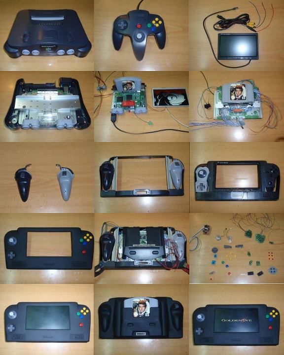

What really prompted this project idea for me was this:
Handheld Nintendo 64.
Thanks for the reply!

There are a TON of handheld NES, SNES, N64, Sony, etc. mods out there.
And yes, you can swap out a case on a phone for a custom case, but there will be some quirks you need to manage.
To understand what you are getting yourself into, first try to find a make/model of a bar phone you can currently buy that will work on today's cellular networks without feeling like it's 10 years old ;)
Once you find a potential project, google around for disassembly tutorials or walk-throughs and pay close attention to the components that are mounted directly to the case.
Many bar-phones have the LCD screen, and the bottom-most layer of the keypad mounted to the main circuit board, but you will find that you will need to carefully mount the remaining components to the inside of your custom case so that they make contact to the circuit board once assembled. Components that are not 'plugged-in' but rely on a spring-like conductor to contact the board may include:
-Vibrator motor
-Microphone
-Ear speaker (not the technical term, but... yeah, it's the little speaker you usually use for listening to conversation)
-Loud speaker
-Antenna
-Battery
-SIM card *(rarely)
The above listed items are not a guarantee to be separate, but should give you a good indication of the kinds of parts you will have to carefully position. If you take the time to research first, you may find some models that have almost all of the components mounted to the board. This will make your job easier, as making sure the parts are aligned internally properly could be a very time consuming frustrating process.
