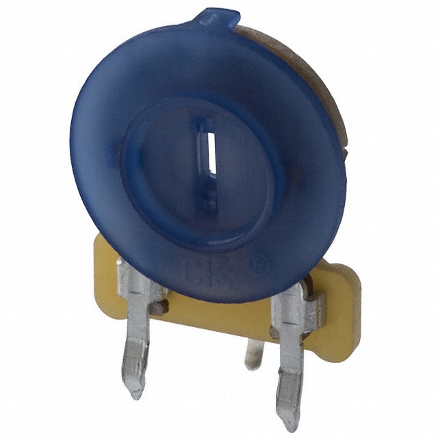

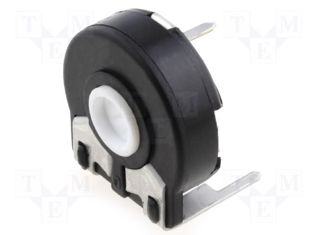

but piher manufactures potentiometers with detachable shafts:
i figure i could just insert a long shaft or something, going through several of these potentiometers. voila! now i've got meeself a custom ganged potentiometer. unfortunately, piher aren't not that big yet, so not many north american suppliers carry them.
another option is to buys these potentiometers (categorized as trimmers in digikey, though i think they're quite big to called "trimmers"), which are similar. i bet i could do the same here:
they are called trimmers because they are defined as trimpots, where they are set and forget, ie. they are not constantly adjusted
Trimpots vary in size from a few mm for surface mount ones up to ~ 1cm (10mm) as in those 2 that you showed above
