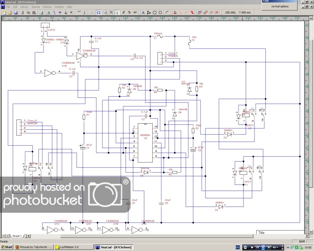

That may well help indeed. Using both sides for jumpers will probably give the space needed to pack in the components onto correct sized veroboard.
Perhaps component side for power and solder side for signals.

Quick update on this one.
I've now conceded that I will have to use a bigger board. This should solve the problems, however I still have one and wondered if anyone had some guidance.
Any suggestions as to wiring up a 556 timer and its associated components (timing network, control voltage caps and in this case a couple of diodes and resistors on the trigger pins - as per schematic above) on veroboard? I have experimented with various layouts but always find myself being 'hemmed in' when trying to connect up the last couple of pins. I'm pretty certain the space is there but its a case of me not utilising it effectively.
I thought there may be a couple of tricks to this kind of thing?

Right, taken me a while but I think I'm there.
Schematic...
Veroboard Component Side....
Veroboard Solder Side...
I've got the timer interlocking circuit there to prevent a timer triggering when the other is already running but I wonder if the relays ought to be wired through each other? I did have an example but it was for an earlier circuit and is now not applicable.
General thoughts? Circuit and design in general and the relay thought?
