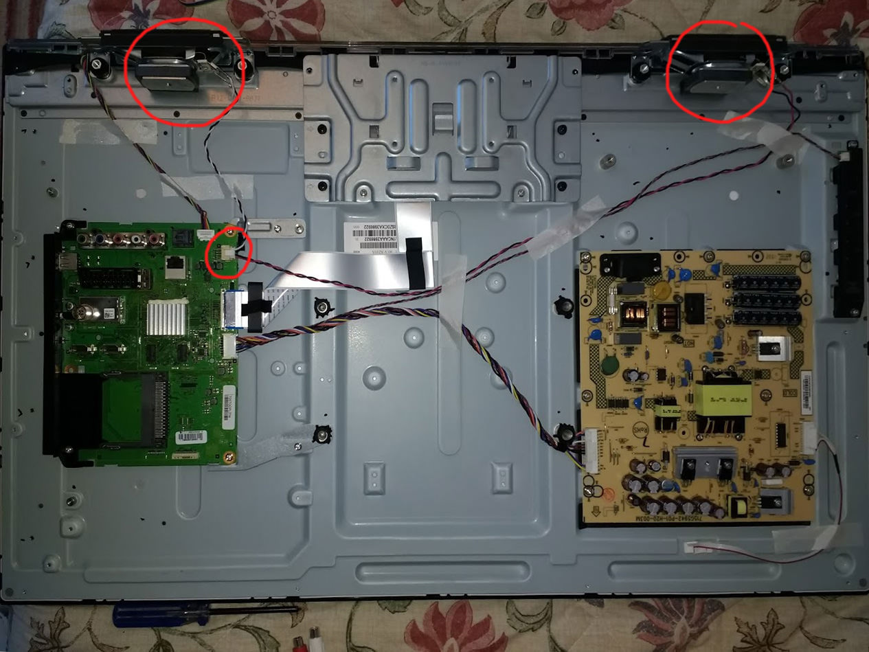

I've inherited a TV with good picture and sound, but absolutely atrocious sound. I want to hook up some old PC speakers up, while retaining the ability to change the volume with the remote.
The TV has an aux input but it's not very good. It has a separate volume setting in a menu somewhere and sound still comes out the internal speakers.
I want to bypass the internal speakers completely to a female aux input which I can plug my PC speakers/headphones into.
Figured it would be pretty easy to bodge something together.
This is what I found inside:
Seems very simple, each speaker (ringed) receives 2 wires from the board, just like 2 phono cables.
I only unplugged the white (left) and red (right) wire from the speaker, the black cables are firmly clamped on.
I wired a female RCA/phono wire to each of the speaker wires, which I connected to my headphones, but the audio was drowned in hiss on both sides.
However, if I just wire the left or right individually, I hear it perfectly clear and crisply through my headphones, it's only when I have both that I get tons of hiss.
And if I connect both female phono wires to one side then I also get a perfectly crisp sound (albeit mono).
Can someone explain what's going on and how do I fix it for perfect stereo?

The outputs are probably bridged, which means neither of the wires are at ground. When you connect both channels to RCA jacks, you are shorting two wires together since each RCA jack has one side going to ground.

Don't do it! If your TV does not have a power transformer then its wiring might be connected to one of the electricity wires in your house. If you connect the TV speaker wires to your stereo then the metal case and speaker wires of your stereo might also be connected to one of the electricity wires which is extremely dangerous because one of the stereo products might be grounded and you will be electrocuted if you touch both products at the same time.
Your headphones have 3 wires because they have one side connected to the other side as the common ground.
But the TV speakers probably have 4 completely separate wires with no common connection between them, the amplifiers are called "bridged", also used in cars. Your headphones probably wrongly shorted the black speaker wires together. Usually that short would destroy the sound amplifier in the TV.

There is a way.
You would need to use an audio isolation transformer between each speaker output and the headphones. After the Isolation transformer, you can connect one wire of each to form the common without shorting the wires from the speakers.

From another forum, someone said this:
As I previously noted, if it's a bridge output you can't join the two black lines, as they are not really ground, but likely biased at a DC level.
The output of a bridge amplifier looks rather like a differential signal with the opposite polarity AC signal (to ground) on each output
Can someone explain in plain English what they meant and if it's at odds with what you understand to be the problem?
It should be okay to join the black lines after the ground loop isolator, correct?
