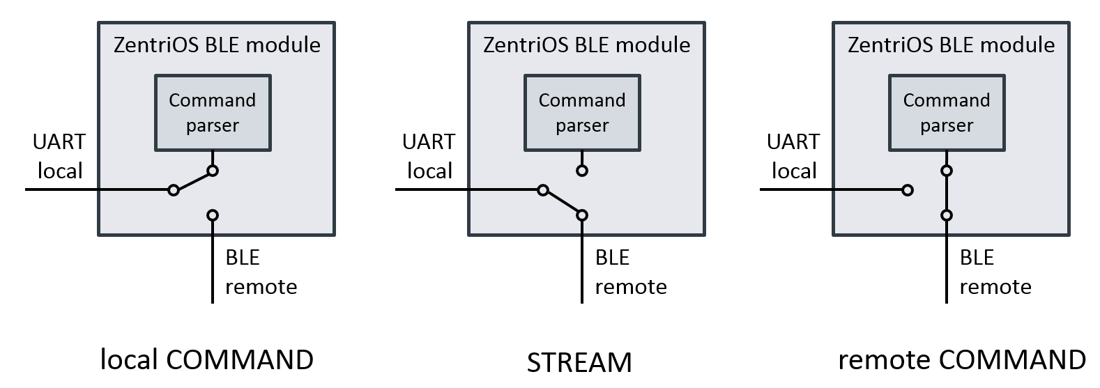

[SOLVED] I found out that the problem I had did not have to do anything with a noisy PSU, in fact the problem occured from any particular power source. The problem was that when I left the UART (TX, RX) pins floating on the BLE module they acted as random bit transmitters/recievers. Since I am new to the UART protocol I never thought this would be a problem. This problem occured while switching the module to remote COMMAND (see picture below) and it looks as if the UART pins are bypassed completely and shouldn't interfere with the transmitted BLE data. But I guess they're in the same multiplexer or something. However I am glad that it worked out nice and my PSU won't need any corrections.
