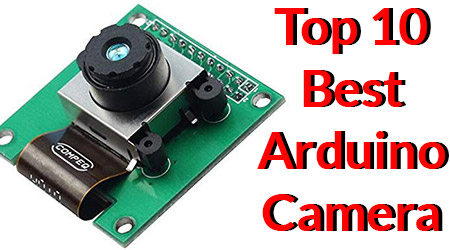

Hello,
There seem to be several cameras for arduino.
The following page shows you a kind of top 10:
