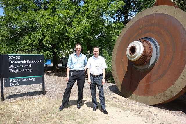

Rotator from the Canberra Homopolar Generator, developed during 1951-1964 at the Research School of Physical Sciences, Australian National University, under the direction of Sir Mark Oliphant. The CMG was dismantled in 1985. Certain parts were constructed into an artwork, and placed beside the school.
With the availability of rare-earth "super-magnets" comes the possibility of constructing a can crusher excited by a homo-polar generator. This would replace the somewhat dangerous high-voltage capacitors with a rotating copper disk. The electrical circuit could be completed with a "hockey puck" SCR which is capable of switching tens of thousands of amperes on a pulse basis. These are now commonly used in capacitance-discharge welders as well as large three-phase motor controllers, Might be a little pricey unless you can find one in used condition. A fast-operating mechanical switch might be good enough for a can crusher, but a triggered arc gap for high-voltage capacitor discharges is cheaper and probably more reliable. Building a triggered arc gap is itself a challenging project.
