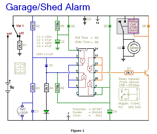

Can someone help describe how this circuit works?

Hi,
Yeah I'm doing an assignment about a garage alarm for college, there seems to be a logic chip in the middle then under certain conditions there is a relay that is activated that activates a siren. How would the relay get activated?
Cheers, Oliver

The transistor drives the relay coil to turn the siren on.
Pin 11 of the 4011 drives the transistor base when high.
The truth table for the 4011 is on the left.
You will need to find out how the capacitors chrge up.

Based on the notations on the diagram, I would say that it it sounds an alarm when the the loop is broken. But there is a delay after turning it on (exit time) and after the loop is broken (Entry time). So, you switch the alarm on, have so much time to go through the door, then it arms. If the loop is broken, you have so much time to turn if off, or the alarm sounds. The details of how this is done are difficult to determine because the circuit is drawn badly and is hard to follow.

As Bob said the circuit diagram is very poor.
My first task here would be to redraw the circuit and then I would calculate the expected voltages at each voltage divider.

Aw, come on guys... its four NAND gates, three of which (2, 3, and 4) are wired as inverters. If the loop is closed when the alarm is SET (turned on) via switch SW1, then input to NAND 1 is held low and its output will be high. This is inverted by NAND 2 causing its output to be low. The low output of NAND 2 is inverted by NAND 3 whose output goes high. The output of NAND 3 is inverted by NAND 4 whose output goes low, preventing the transistor from conducting. Thus the alarm does not sound.
If the loop is opened, then all of the NAND outputs change states, but with a delay for NAND 3 while C4 charges through R6. After the delay NAND 3 output goes low, NAND 4 output goes high, and the transistor is turned on through base current-limiting resistor R7 to energize the relay and the alarm sounds. The delay allows the loop to be opened on re-entry to the premises without immediately sounding an alarm. However an LED is illuminated via R4 as a reminder to turn SW1 to OFF before the alarm sounds.
If the loop is not closed yet when SW1 is moved from OFF to SET, then uncharged C2 keeps the input on pin 1 low until it charges sufficiently to present a logic high input, enabling the other high input (caused by the open loop) of NAND 1 to sound the alarm. This delay allows time to set the alarm and subsequently close the loop after exiting the premises.
Diode D1 latches the alarm on after the loop is broken and entry time delay has expired, ensuring that even a brief interruption of the loop after it is "armed" will cause the alarm to sound. Diode D2 and D3 discharge capacitors C2 and C4 respectively through R1 when switch SW1 is placed in the OFF position. Diode D5 protects the transistor from back emf of the relay coil. I have no idea what D4 does.
Pretty cool circuit that doesn't use much power until the alarm is tripped. The 9 V "transistor radio" battery should last for at least the shelf life of the battery, several years if alkaline type is used.
Of course simple loop alarms are easily defeated by placing a jumper around the device that opens the loop. That's why a balanced current scheme is used with professional installations. This circuit should be "gud enuf" to protect a home garage or shed. Most thieves know nothing about intrusion detection systems, and even less how to defeat them.
