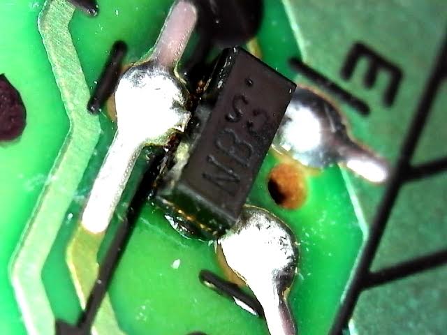

Can someone ID this Transistor ? Offer Equivalent part ?
William Heckman
Jun 19, 2015
4
Jun 19, 2015
4
Its from a SHARP TV LED. Model: LC-26DV24U. Specfically its Q419 on the Power board. Thanks in Advance.

hi William, welcome :)
NB could be a BF599 or a FMMTA55R
I have those 2 listed for that code ... but with the same code often used for many different devices from different manufacturers, one can never be sure
in this case, those 2 choices are the most likely
A service manual would be the only way to tell for sure

Yes, that part matches up with common parts in the SHARP service guide that I have. Multiple points on the board with that part...
Now... WHERE TO BUY THIS PART ????

no they weren't equiv's they were what was listed for the NB SMD code

hence why I followed the comments with the proviso of same code for many part numbers
in this case those 2 I gave were no good
the Q419 transistor, a compound transistor = a digital transistor with 2 built in resistors and is NPN
the best data for the KRC102SRTK is this one .....
http://pdf.datasheetcatalog.com/datasheet/kec/KRC101_6S.pdf
and that datasheet even shows the correct SMD code NB
Dave

If Sharp cannot supply a replacement, it may be difficult to find one considering it's a specialist type

So I tried to order parts, and the website came back and explained they no longer have them... Any ideas on an eqivalent part anyone ?
