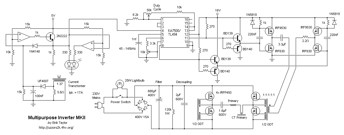

Hello guys,
I was wondering if anyone can look over my PCB layout for a Circuit diagram,
The circuit is a Inverter Driver for a Full bridge that will be driving a large Ferrite Transformer.
PCB Layout:
index.php
Circuit Diagram:

I think connection is ok. No problem but be careful about your experiment.

Circuit is OK excepting that the power switch needs to be closed by a time delay relay to avoid catastrophic damage to power semiconductors.

All connection is ok no problem at all. keep it up and go ahead.
