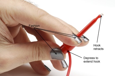

My . . . My . . . .My . . . . now, this is where your real "Canadian ingenuity" comes into play, you should find that a 1/4 watt carbon resistors lead should be a snug fit into that meters transistor socket.
Cut three 1/2 inch lengths of that size of wire and make center L bends , then get three lengths of lighter gauge hook up wire and solder tack them to the L wires ends. Then the neatest thing to use is 3 of these.
Hook clips that connect to the loose wire ends and then the test clips clip onto the transistor being tested.
The hook clips are cheapest from Radio Shack, if Canada has, or ever had such.
You could color code each with paint or label with stick on tape .
That adapter should then hold a solid electrical connection to let you test a transistor.
