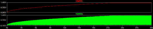

The results from the LTspice simulation. Beware that sometimes the simulators lie.
In the first plots the the red line is the voltage across capacitor c1. The green line is the voltage at the mosfet drain. The voltages peaks at 1.34 kv in 24 seconds. The green plot is solid as it is maded up of pulses. The breaks in the red plot are do to the scaling in the Gimp image processing software.

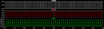

In the next three plots; the white plot is the input to the mosfet. 6v peak, 50hz, 20ms high and 20 ms low. The red plot is the current from the mosfet; at 0.905 amperes. While the green plot is the current through one of the coils at 0.301 amperes.
Attach is the circuit as used in the simulation. Using components close to the original circuit that the simulator has.
