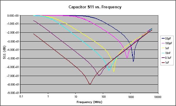

The circuit is a voltage regulator system and it designed to keep a constant reference output. Ideally we want the input to not change too rapidly as this would lead to poor regulation of the output. The capacitor is designed to filter out high frequency(rapidly changing) signals to allow proper functioning of the internal regulation circuit. The chosen capacitor value will allow for rapidly changing signals to be filtered out.
The first extreme would be choosing the value of capacitance too low, which would mean some rapidly changing signals will still pass through to the regulator circuit and lead to an unstable output. The second extreme is seen from this graph:
capacitors are not ideal and actually start to behave as inductors for very high frequency signals, this depends on the value as well as type of the capacitor. Choosing a to high value will actually cause the opposite effect of what the capacitor is chosen to do. Leading to again an unstable system. Hope I was clear enough

The graph shows that the larger capacitors are only effective at lower frequencies. The dip depends on the capacitor proper and the length of the leads. The leads should be as short as possible.
In your diagram C3 is placed further away from the regulator than C2. Shift it as close as possible to reduce lead length.
