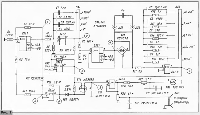

The one who is engaged in repair of household or industrial radio equipment knows that it is convenient to check the serviceability of capacitors without dismantling them. However, many capacitor capacitance meters do not provide this capability. True, one such construction was described in [2]. It has a small measurement range, a nonlinear scale with a countdown, which reduces accuracy. When designing the same meter, the task of creating a device with a wide range, a linear scale and a direct reading was solved, so that it could be used as a laboratory one. In addition, the device must be diagnostic, i.e., capable of checking and capacitors, shunted with pn junctions of semiconductor devices and resistances of resistors.
The principle of operation of the device is as follows. The input of the differentiator, in which the tested capacitor is used as a differentiator, is supplied with a triangular voltage. In this case, at its output, a meander is obtained with an amplitude proportional to the capacitance of this capacitor. Next, the detector selects the amplitude value of the meander and gives a constant voltage to the measuring head.
The amplitude of the measuring voltage on the probes of the device is about 50 mV, which is not enough to open the pn junctions of semiconductor devices, so they do not exert their shunting effect.
The device has two switches. The “Scale” limit switch with five positions: 10 μF, 1 μF, 0.1 μF, 0.01 μF, 1000 pF. The "Multiplier" switch (X1000, x10O, x10, X1) changes the measurement frequency. Thus, the instrument has eight capacitance measurement ranges from 10,000 microfarads to 1000 pF, which is practically sufficient in most cases.
The generator of triangular oscillations is assembled on the OA of the microcircuit DA1.1, DA1.2, DA1.4 (Fig. 1).One of them, DA1.1, operates in the comparator mode and generates a square wave signal, which is fed to the input of the DA1.2 integrator. The integrator converts rectangular to triangular. The frequency of the generator is determined by the elements R4, C1 - C4. In the feedback circuit of the generator there is an inverter on the OA DA1.4, which provides a self-oscillating mode. With switch SA1 you can set one of the measurement frequencies (multiplier): 1 Hz (X1000), 10 Hz (x10 O), 10 OHz (x10), 1 kHz (X1).
Zoom
OA DA2.1 is a voltage follower, at its output is a triangular signal with an amplitude of about 50 mV, which is used to create a measuring current through a tested capacitor Cx.
Since the capacitor capacitance is measured in the board, there may be residual voltage on it, therefore, to prevent damage to the meter parallel to its probes, two anti-parallel diodes of the bridge VD1 are connected.
OU DA2.2 works as a differentiator and acts as a current-voltage converter. Its output voltage is:
Uout = (Rl2 ... R16) · IBX = (Rl2 ... Rl6) Cx-dU / dt.
For example, when measuring a capacitance of 100 µF at a frequency of 100 Hz, the result is: Iin = Cx · dU / dt = 100-100MB / 5MC = 2MA, Uout = R16 · lBX = 1 kΩ · mA = 2 V.
The elements R11, C5 - C9 are necessary for the stable operation of the differentiator. Capacitors eliminate oscillatory processes on the fronts of the meander, which make it impossible to accurately measure its amplitude. As a result, the output of DA2.2 is a square wave with smooth fronts and an amplitude proportional to the measured capacitance. Resistor R11 also limits the input current when the probes are closed or when a capacitor is broken. For the input circuit of the meter should be the following inequality:
(3 ... 5) CxR1 <1 / (2f).
If this inequality is not fulfilled, then for half the period the IBX current does not reach a steady-state value, and the meander does not reach the corresponding amplitude, and an error in measurement occurs. For example, in the meter described in [1], when measuring a 1000 microfarad capacitance at a frequency of 1 Hz, the time constant is defined as
Cx · R25 = 10OO microfarad - 910 Ohm = 0.91 s.
The half of the T / 2 oscillation period is only 0.5 s, therefore on this scale the measurements will turn out to be noticeably non-linear.
The synchronous detector consists of a key on a field-effect transistor VT1, a key control unit at an opamp DA1.3 and a storage capacitor C10. OA DA1.2 generates a control signal to the key VT1 during the positive half-wave of the meander, when its amplitude is set. Capacitor C10 remembers the constant voltage allocated by the detector.
From the capacitor C10, the voltage carrying information about the value of capacitance Cx is fed to the microammeter PA1 through the repeater DA2.3. Capacitors C11, C12 - smoothing. From the engine variable calibration resistor R22 voltage is removed to a digital voltmeter with a measurement limit of 2 V.

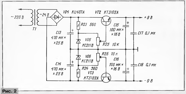

The power source (Fig. 2) produces bipolar voltages of ± 9 V. Reference voltages form thermostable Zener diodes VD5, VD6. Resistors R25, R26 set the required output voltage. Structurally, the power source is combined with the measuring part of the device on a common circuit board.
The device used variable resistors type SDR-22 (R21, R22, R25, R26). Fixed resistors R12 - R16 are of type C2-36 or C2-14 with a tolerance of ± 1%. Resistance R16 is obtained by connecting several matched resistors in series. Other types of resistors R12 - R16 can be used, but they must be selected with a digital ohmmeter (multimeter). The remaining fixed resistors are any with a power dissipation of 0.125 watts. Capacitor C10 - K53-1A, capacitors C11 - C16 - K50-16. Capacitors C1, C2 - K73-17 or other metal-film, C3, C4 - KM-5, KM-6 or other ceramic with TKE are not worse than M750, they must also be selected with an error of no more than 1%. The remaining capacitors - any.
Switches SA1, SA2 - П2Г-3 5П2Н. In the design, it is permissible to use a KPZAZ transistor (VT1) with letter indices A, B, B, F, I. The transistors of the VT2, VT3 voltage regulators can be replaced by other low-power silicon transistors of the corresponding structure. Instead of OU K1401UD4, K1401UD2A can be used, but then an error may occur at the limit of 1000 pF due to a shift in the input of the differentiator created by the input current DA2.2 to R16.
The power transformer T1 has an overall power of 1 watt. It is permissible to use a transformer with two secondary windings of 12 V, but then you need two rectifier bridges.

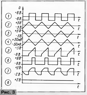

An oscilloscope is required to set up and debug the instrument. It is nice to have a frequency meter to check the frequency of the triangular oscillator. Exemplary capacitors will also be needed.
The device begins to adjust with the installation of voltages +9 V and -9 V using resistors R25, R26. After that, the operation of the generator of triangular oscillations is checked (oscillograms 1, 2, 3, 4 in Fig. 3). In the presence of a frequency meter, the generator frequency is measured at different positions of the switch SA1.It is acceptable if the frequencies differ from the values of 1 Hz, 10 Hz, 100 Hz, 1 kHz, but they must differ exactly 10 times between themselves, since the correctness of the instrument readings on different scales depends on this. If the generator frequency is not a multiple of ten, then the required accuracy (with an error of 1%) is achieved by selecting capacitors connected in parallel with capacitors C1 - C4. If the capacitances of capacitors C1 - C4 are selected with the required accuracy, you can do without measuring frequencies.
Next, check the operation of the OA DA1.3 (oscillograms 5, 6). After that, the measurement limit is set to "10 microfarads," the multiplier is set to the "x1" position, and a 10 microfarad capacitor is connected. At the output of the differentiator, there should be rectangular, but with tight, smoothed edges of oscillation with an amplitude of about 2 V (oscillogram 7). Resistor R21 expose the readings of the device - the deviation of the arrow at full scale. A digital voltmeter (at the limit of 2 V) is connected to the sockets XS3, XS4 and the resistor R22 is set to 1000 mV. If the capacitors C1 - C4 and the resistors R12 - R16 are precisely selected, then the instrument readings will be multiples on other scales, which can be checked with the help of model capacitors.

DA1,DA2-TL084
VT1-BFW12,2N3466
VD1-1N5216,4x1N4007
In the scheme it is necessary to swap inputs 5 and 6.

Test signal.

Hi @caps you seem to be putting a lot of effort into this, but some of us are scratching our heads a little.
What I think you're doing is taking an old Soviet(?) design, and posting it here with an English translation.
Here are some things you might consider to make your thread more useful:
  • Please tell us the purpose of this thread if it's not what I think it is.
  • What are the advantages of this circuit over capacitance ranges on multimeters or other capacitance meters?
  • Please consider re-drawing the circuit diagram to use more modern symbols and Western style abbreviations, e.g. Ω, V, μF, etc.
  • Please provide a cross-reference for what appear to be Soviet part numbers to more easily obtainable (in the West) parts.
  • Consider modernising the power supply (why not use 3 terminal regulators?).
  • Describe why you are showing images of readings. I don't know which scale I should be looking at or how I should be interpreting it
  • At one point you refer to "capacitors with an oxide dielectric (K50-6, etc.) with a capacity of 1 microfarad to 10 microfarads". Do you simply mean "electrolytic capacitors between 1μF and 10μF"? Does the reference to K50-6 hold any special meaning, because if it does, it's lost on me.
  • What is part VD1? Is it a bridge rectifier with only 3 pins connected? Or is it something like a TL431? If it's the former (which I believe it is), why not simply use a diode?
  • I understand that this circuit may have the ability to read fairly accurate capacitance with some parallel resistance. If this is true, mentioning it up front would have been useful. What about the presence of semiconductor junctions? Does it limit the test voltage to below (say) 0.5V to reduce their effect on the readings?
  • An overall, high level, explanation of the operation would be useful. Something like "this circuit imposed a xxxx waveform at one of several frequencies across an unknown capacitor. Yyyy is measured resulting in a linear increase in output voltage with capacitance. Moderate values of parallel resistance do not significantly affect the reading because zzzz."

Your recent posting of the "test" waveform has no real use for me. I think you're showing an actual waveform compared to a predicted value, but...
  1. I don't know how the scope was set up. What is the horizontal timebase.
  2. What is the vertical sensitivity.
  3. Where is 0V (or maybe you used AC coupling)
  4. The waveform you show is not symmetrical. It this correct? Incorrect? Close enough? Something to check?
  5. Why is it necessary to check this? Or is it just a bit of show and tell (without the tell)

"What are the advantages of this circuit over capacitance ranges on multimeters or other capacitance meters?"
Measurement directly in the circuit.
  • What is part VD1? Is it a bridge rectifier with only 3 pins connected? Or is it something like a TL431? If it's the former (which I believe it is), why not simply use a diode?"
I have indicated 4 diodes, a diode bridge.
  • "I understand that this circuit may have the ability to read fairly accurate capacitance with some parallel resistance. If this is true, mentioning it up front would have been useful. What about the presence of semiconductor junctions? Does it limit the test voltage to below (say) 0.5V to reduce their effect on the readings?"
Yes. 50mV does not open semiconductors.
  • "Your recent posting of the "test" waveform has no real use for me. I think you're showing an actual waveform compared to a predicted value, but..."
I just wanted to show that the measuring signal corresponds in form to the original.
I was referring to this:
Should we assume the same orientation as this:
And if so, do you mean this?
Which is nothing more than a pair of diodes in inverse parallel across the terminals. Why specify 4 diodes?
caps
Jul 29, 2018
183
Jul 29, 2018
183
This is protection against charged capacitors.
There may be 2 diodes or 4.

However that's a pointless test as I pointed out before. The meter will never exceed 9V because your power supply is only 9V between ground at the +ve rail.
Try doing that with a 4700μF capacitor.
I would not trust any output of that circuit over 8V.
It would be far better if the power supply was +/-12V because then you have some headroom.
