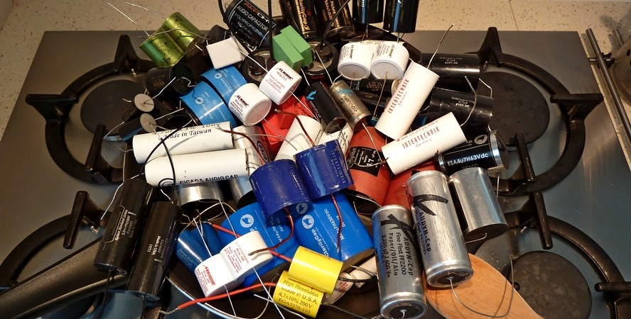

Beginning to build a sine wave generator for 1KHz sine to test amplifier circuits for distortion. I have several examples I will be working from. The idea is to have ultra low distortion in the 0.005 or better range. My question is in the low pass filter of the Op Amp circuit what is the best capacitor type , Ceramic, mica, Polyester film? Yes I know the choice of Op Amp is critical for low distortion, I have several Burr Brown op amps that will more than meet the spec, so really the question is strictly about the capacitor.

(Almost) anything but no electrolytic. Don't even think of it.
[Edit] When using MLCCS, note that these can show piezoelectric effects. In this article the "singing" of ceramic capacitors is described. There is also the inverse effect: mechanical stress can induce voltages in this type of capacitors which will show up in the output of the filter. You may want to avoid this effect by using film capacitors.

Ceramic and mica are generally reserved for higher frequencies than the kHz range - you will be limited by the absolute minimum values required which will take you into the polyester, polypropylene, MLCC types.
Check this out:
Great article, very close to one of the circuits I was going to be working from. I was in fact going to NOT use the lamp you see in many of these circuits and use another approach. After reading this article I will start with the lamp idea and experiment from there. The answer to the capacitor question is Polypropylene film. Thanks much!

The top-tier capacitor is probably polystyrene used for excellent stability, low noise, low leakage, etc. Used a lot in RF. They lost some favor over the years due to not being compatible with auto-insertion and their limited range of values but with low tolerance rating. But you will still see them in highly critical audio circuits like phono cartridge RIAA EQ circuits and the like, hand stuffed and hand soldered, 1-2% tolerance. Here's a selection of surplus polystyrene caps. Just scroll until you find the 0.005uF Mallory:
That one is a 5% but one can "build" lower tolerance by paralleling 1 or 2% values. Just FYI.

What planet do you live on? Your reply makes no sense and is just wrong. You've got "polystyrene" mixed up with some other dielectric that maybe sounds or spells similar. Legacy polystyrenes are not auto-placed as most all are axial. And why are you associating the RIAA phono playback curve and "grooves" so vehemently with my use of that application as an EXAMPLE. Read this and back off.

If you read your original post you were asking about the best 0.005uF cap technology for a low pass filter and I answered your question = polystyrene and I told you where to get them. The only thing "better" could be Teflon. I had no intention of discussing anything at all about the overall design. Maybe I thought your reply was in direct response to my reply so I missed that. I'm new here.
