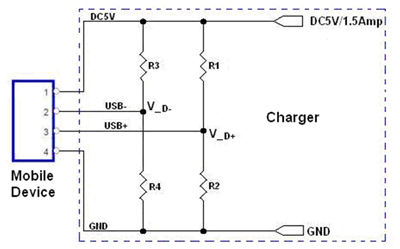

Just found this on some website (instructables). Apparently what android phones require.
R1=75k ,R2=R4=51k,R3=43k

If I read it correctly the above diagram gives 2 different voltages to pins 2 and 3 whereas my spice diagram sends the same voltage to pins 2 and 3
