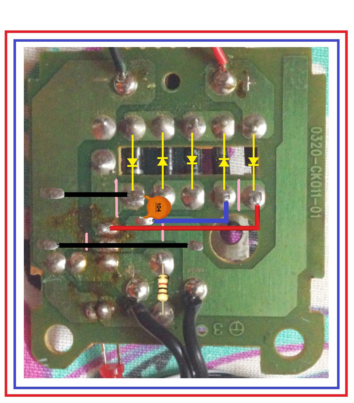

Sir Nauman Muhammad . . . . . . .
Yes, that regulator is indeed being a 6 volt unit, so that is just less voltage that we will have to drop.
Consulting the mark up:
It will need 4 foil paths to be cut enough to leave gaps. they are being marked in PINK
I just color coded the diffferent wires for clarity.
It will need one RED jumper wire to get raw 12V + DC over to the input terminal of the 3 terminal regulator, since we have cut open that series diode string path and are now going to use them in another manner.
We need the BLUE jumper wire to make connection to one end of our new repurposed series diode path.
We need two BLACK jumper wires to carry ground connections to newly created positions.
Scrape the green resist from the foil to solder tin those areas initially.
We need the 0.1 ufd for HF filtering bypass.
When you get this done, load the supply with the previously mentioned load resistor, you should come up with less than the full 9 volts.
Then, that will let us see how many more series diodes need to be added in the string to trim on into 9 olts..
Here's . . . . . The Plan . . . . . .man . . . .
73's de Edd

Oh thats great!
I am starting work on it. But before it I need to clear that?
I need to break the circuit at pink marks?
I did not understand this point "Scrape the green resist from the foil to solder tin those areas initially.
We need the 0.1 ufd for HF filtering bypass."
Thanks..
Yes, use a single edge razor blade, Exacto hobby knife, surgical scalpel or SHARP pocket knife and cut two lines, side by side, in the copper foil, about the width of a metal paper clip and then peel the strip out. It will then leave a small gap in the copper foil.
You can not solder to a point that is covered with that green resist, until you scrape it off enough to reveal the bare copper foil that is beneath it.
We need the 0.1 ufd for High Frequency filtering and bypassing."
That is just an added part that we need to place in the circuit, it is the round orange capacitor, old equipment has MANY of these being used in their circuitry..
