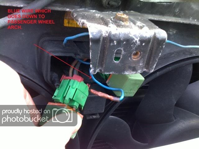

Hi guys,
Basically my radiator fans on my car have stopped working and the origional wiring loom has been hacked into.
Now warmer weathers approaching, i really dont fancy my engine cooking itself.
Basically i was just wondering if anyone could help me design a circuit and list what i would need to make the circuit work?
I'm guessing 12v car battery (allready on car), cable, and a switch? (mounted inside the car)..
Would there be anything else needed such as fuse's etc?...
Many thanks

Basically i've got to the point where my radiator fans have stopped working as you know.
The car is a 1997 peugeot 306 GTI-6 with aircon.

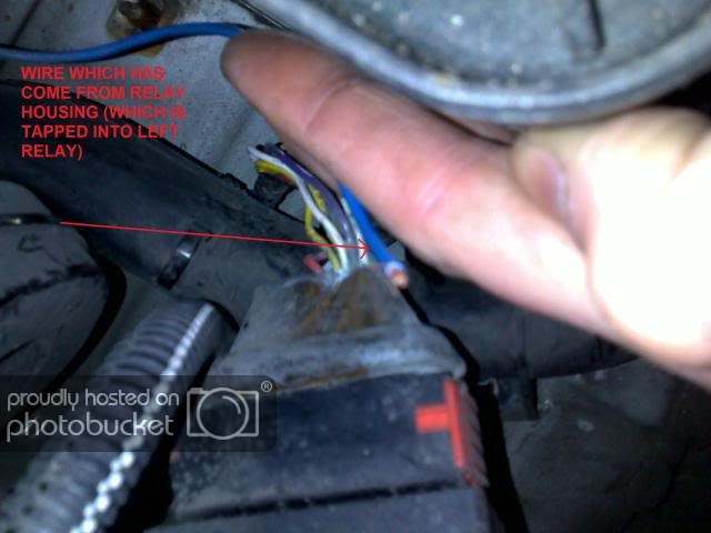

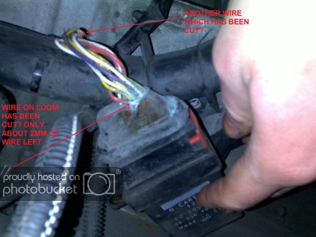

For some reason i have a blue wire which is connected to one of the relays in the fan housing system which trails down to the bitron unit. Now the bitron unit appears to have been snipped into for god knows what reason but it appears that the wires have been connected in the past and may have come apart. I put the wire's together and unplugged the brown sensor of the thereostat housing which is a temprature sensor and i can hear a faint clicking when the wires are joined which is the relay i assume?.. But the fans dont come on. Its near on impossible to connect the wires back together as the wire which comes off the loom has been snipped out with only around 2mm of cable left. Pain in the backside!
All i'm wanting to do is buy an uprated single fan unit and remove the origional fan's and have the new fan on a simple on/off switch
So basically,
12V battery - Fuse - Switch (on/off) - Fan.
Cheers

Yes, it's a real pain with hacked wiring.. Did you check F33 & 34? It should be easy to establish if the fan motors are bust or if it's something else (fuse/ relay/ control).
Now, I don't mind modding Peugeot's but seeing how the A/C is interconnected with the fan controller I'm worried that you may stand to loose several & important (safety) functions and/or warning lights.
The use of five fuses, three relays, two fans, a ten wire control unit, & a four-step A/C pressure switch makes for a rather complex control system.
The changeover relay allows for running the fans in series. This mode is probably used when the A/C is operating. Some airflow must be on when A/C is on.
The close-cut wire seems to be in a boot that can be remove for better access. I'd try to fix it, soldering if I'd have to. Do you have a DVM or a test lamp?

Ok, manual it is then, hope you have a working temp gage to go by..
Fans draw a lot of current so a relay is in order. Hook both its contact and coil up to B+ via a fuse. Connect the other contact to the fan, and ground the other end of the fan. Draw a control wire from the other end of the coil in to the switch, and ground the other end of the switch. That's all.
