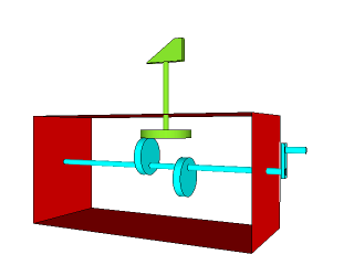

I have an ancient "drill press" adapter for use with earlier model Dremel Moto-Tools. Instead of moving the quill (the Dremel Moto-Tool) up and down, a cam underneath the table moves the table up and down when the cam is rotated manually by means of a knob, shown below and to the right of the table, in the image below. So, if you have sufficient room under your platform, you could rest it on a cam that moves it up and down 100mm, or about 4 inches, under the control of a geared PMDC motor. Easy to add micro-switches, actuated by the cam, for use as limit stops.

That's an interesting mechanism and that idea may be useful for another project I've got in mind - but unfortunately the platform is dropping from a hidden void in a cupboard, so it can't have anything underneath it. I've gone for the 100mm motors (which will no doubt take a while to arrive from China), so knock up a platform in anticipation of their arrival.
