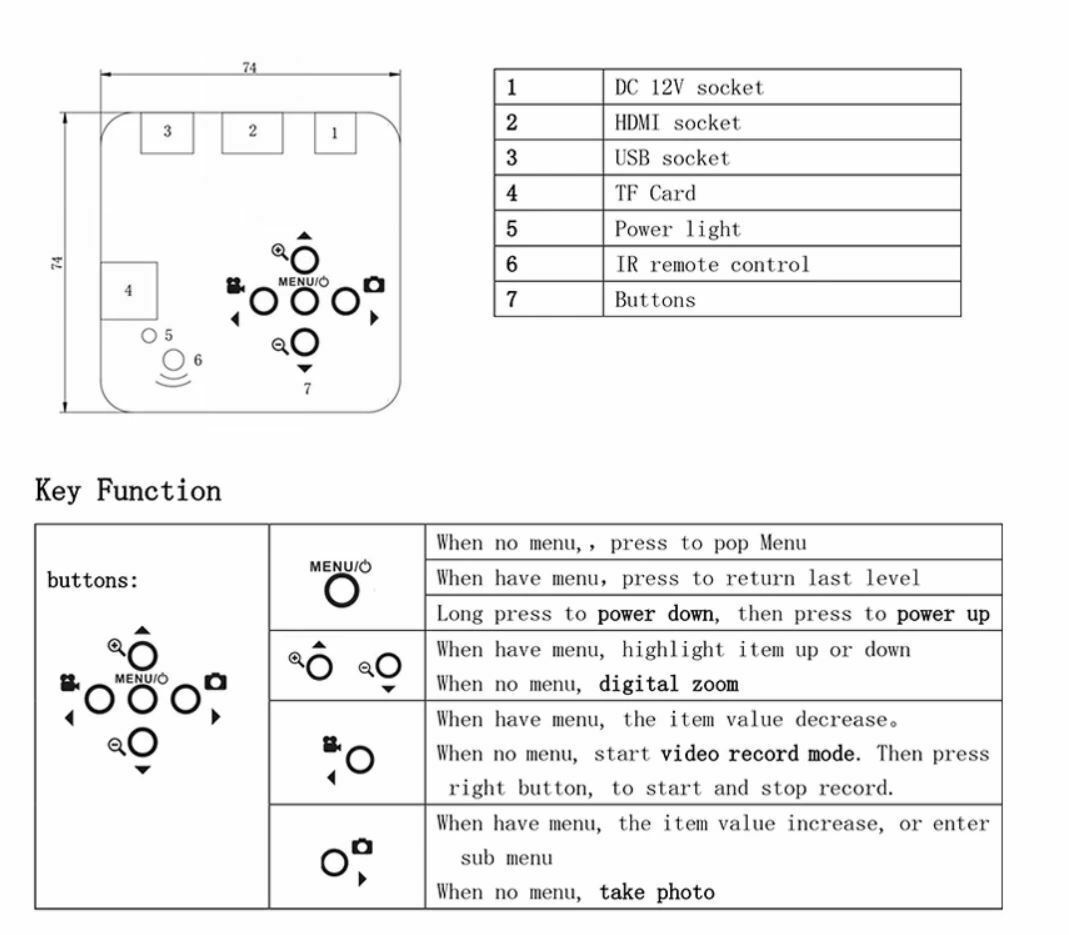

Thanks for the links narkeleptk :) I saw those cameras in different places. Most of them has very high resolution CMOS chips (e.g. 38MP). Do you know if this feature can be used to make extra zoom ? That does not seem to be written on the aliexpress pages. and because the HDMI signal is in 1080p I don't see the point of such big sensors (except to take photos) if we can't zoom, and thus will go for a lower resolution camera.

No idea. it has buttons for zoom that I imagine work when hooked to a hdmi source. The Northridge Fix guy on youtube uses this style, maybe shoot him a message asking about it.
Ive only used this type cam with usb and on a trinocular stereoscope. The buttons dont seem to function with usb and magnification is done by the lenses. The setup in links I sent looks like its meant to function the same way and has been whats popular lately.
I dont know anything about camera's and dont have a good eye for this type of stuff but I dont think the image quality is all that good already. Not sure if you can really go by what is being said so I'd hate to see what the lower resolution listed camera's looked like. I have this one to https://amscope.com/products/cl-uhm350 and I dont really see any difference between the two video wise.

I did some research and according to picClick, the cameras in the aliexpress link do have the ability to do digital zoom. The ebay page of the same camera (found on picClick) states that with the maximum zoom using the 300x lens, one can have a field of view of 1mm on screen. Which I think is largely enough.
