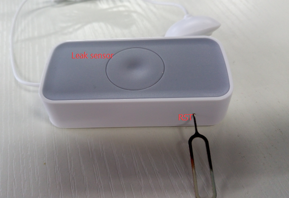

- Send: [UART] 02 75 1E
- Success response: [UART] 02 8A 00
- Insert the pin to the reset hole and hold, until the green light is blinking very fast.
- If the light blinking is not fast, just release the pin and insert it again until it is blinking very fast.
- This will set the ZigBee sensor into reset mode.
- Send Set Permit Join commands to join
- After a while, gateway will get the response–** New Device Joined Indication**
