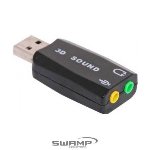

The above a sound card oscilloscope. Good to ~ 20 Khz. Make sure you protect your sound card inputs, google
"sound card oscilloscope protection circuits"
If youd ecide to go this route also buffer the generator output, eg. sound card output.
Some folks have gotten throw away sound card dongles to insure protection for PC. Or
just keep a spare sound card on hand in case you hose it. But if you provide adequate
protection for inputs and outputs you should have no problem on "normal" low voltage
stuff or use 10X, 100X probe interface, on top of the protection.
Regards, Dana.
