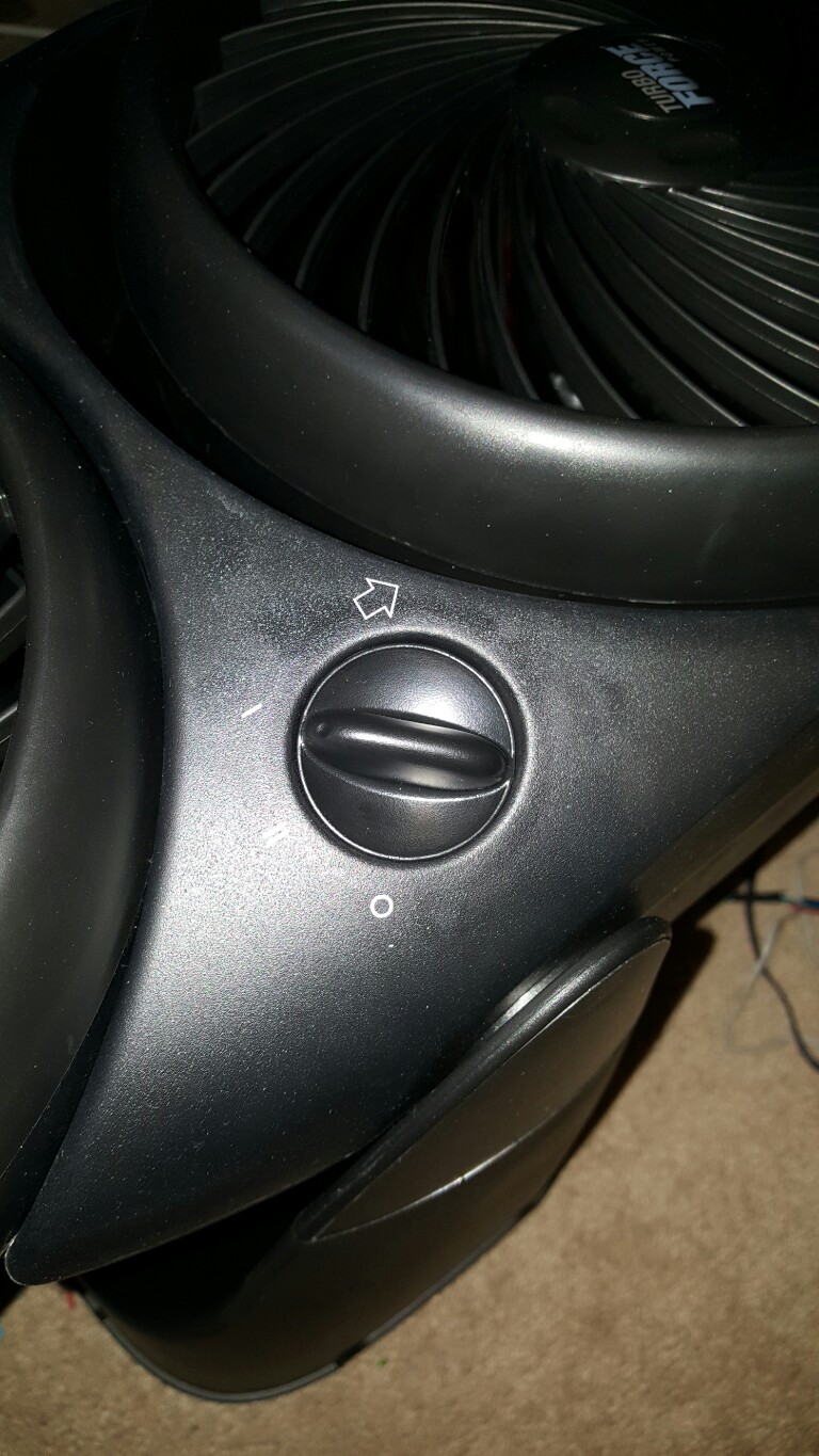

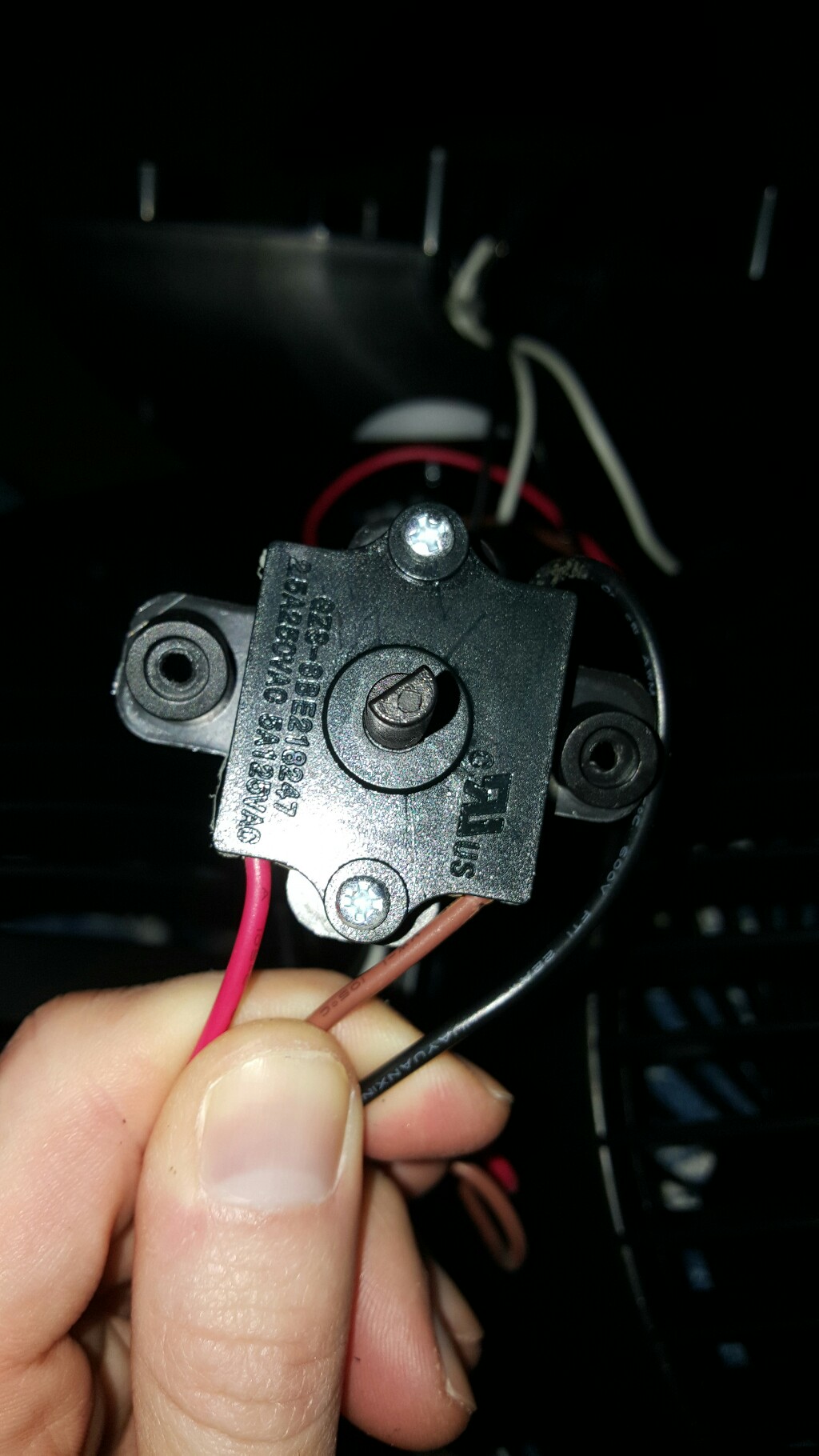

Hey all I am wondering what all I would need in order to control this knob on my Honeywell 2-in 1 Air Circulator Fan, HT-9700

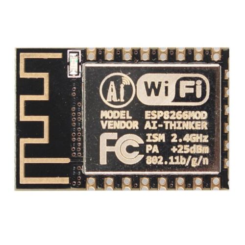

I am wanting to use a ESP8266 in order to control it via wifi. I know how to do it on that side but I am unsure what's available for the other side (the knob) in order to "turn" the knob or hook into the knob wires.

I don't know what the knob does but you need to know how its wired. If you don't have a diagram, you could disconnect the wiring to the switch and make note of how continuity changes with each wire in each position.
Then you could have a relay to replicate the switch movement that's driven by your WiFi module. You will need separate control for each switch position.
Easier yet, just leave the fan switch on and have your module switch the line power to it.

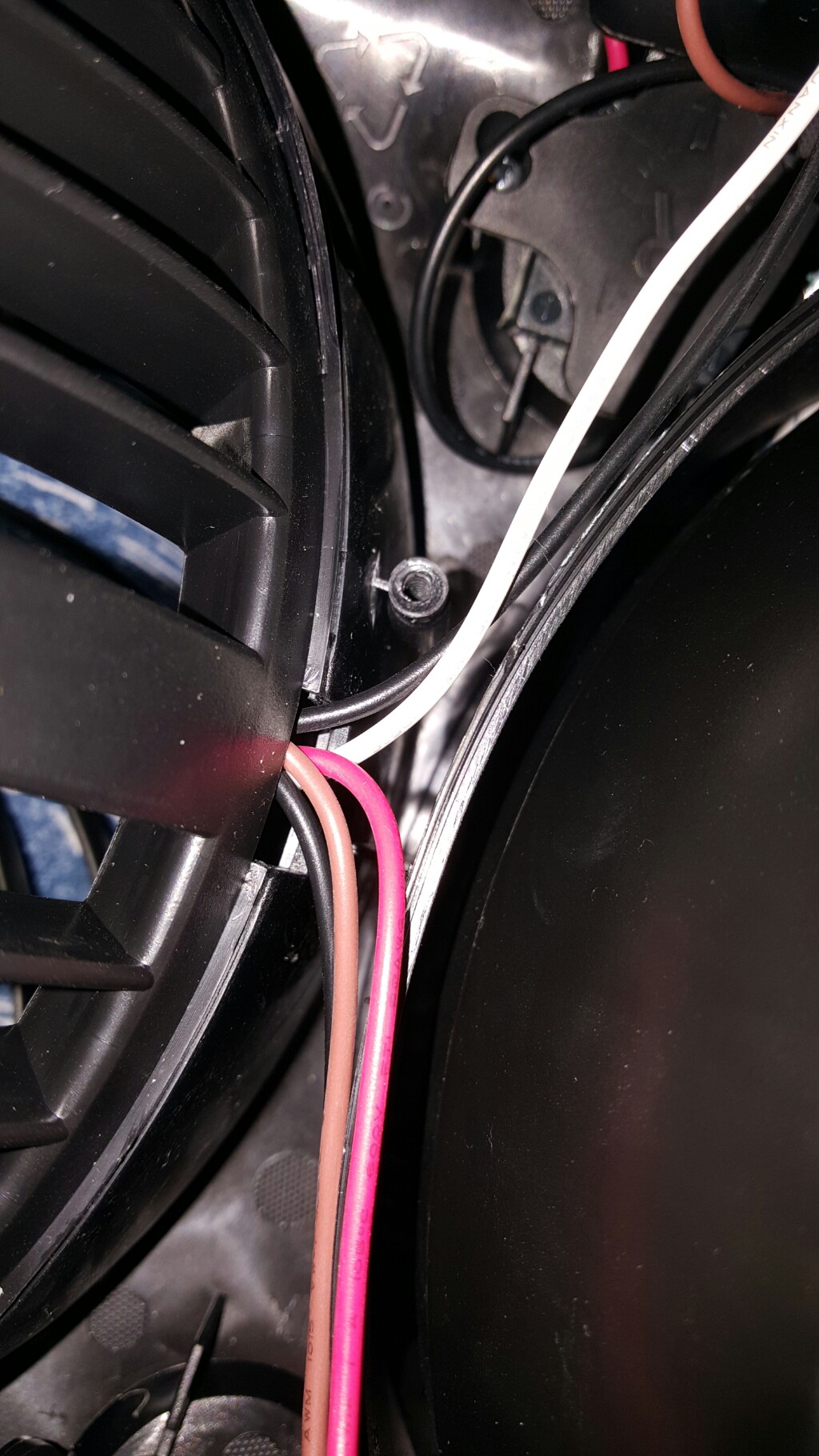

OK So here it is:
BROWN wire = Low fan speed
RED wire = HIGH fan speed
BLACK wire = HOT
With the black prob on BLACK and the red prob on RED with the fan ON/HIGH I get: 09.9
With the black prob on BLACK and the red prob on BROWN with the fan ON/LOW I get: 00.0
With the black prob on BLACK and the red prob on RED with the fan OFF/OFF I get: 124.4
With the black prob on BLACK and the red prob on BROWN with the fan OFF/OFF I get: 124.4

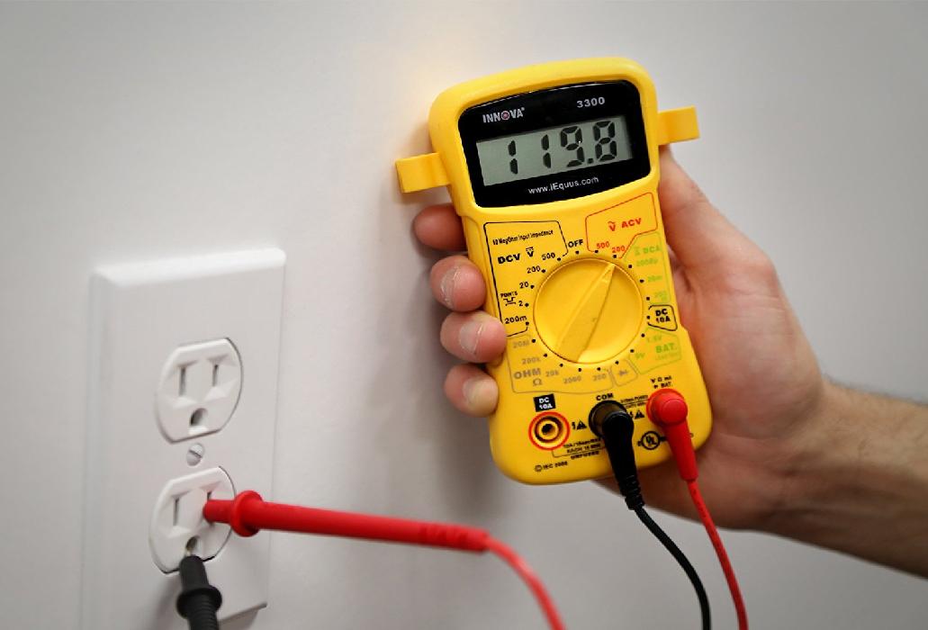

Note I am using the AC mode on my multi meter that looks like this:

I take it that the RED and BROWN wires still need to be connected inside the rotary knob housing in order for this to work?

All the fan motor cares is if it has electrical pressure. You could run the Red and Brown from the fan directly to the relay eliminating the switch function. Or have the switch paralleled like my sketch. That way the switch can override the relays.
A note of caution: I don't know if the fan needs only power on the Red wire or both Red and Brown when running high speed.
If the motor is designed to run with only power on the Red wire, it could be a problem if the switch was set on high and your relay feeding brown came on.
Take some measurements with your meter to verify how the motor functions on high.

when i connect both RED and BROWN to the BLACK and RED probes i get 124.2 but the fan does not run. Taking off ether the RED or BLACK probe and it runs.

Measuring from the incoming White(neutral) wire to the brown wire going to fan, with the fan switch set to high speed. Make note of voltage.
Now, move one probe from the brown wire onto the red wire with switch still set to high.
Make note of this voltage also.
If both brown and red are energized (120v) with respect to common neutral when set to high speed. All should be fine.
But, if only red is energized (and not brown) on high speed, you don't want the switch set to medium and your esp control relay energizing the red (high speed) wire simultaneously.
If the latter is true you should either interlock the switch, or just eliminate it and wire directly to the fan.

Ok here are my findings:
Code:
White + Brown on HIGH = 134vac
  White + Red on High = 124vdc
And just for kicks I went ahead and did LOW:
Code:
White + Brown on LOW = 124vdc
  White + Red on LOW = 114vdc

Ahh, your getting feedthrough voltage back from motor winding. A loaded meter would give better readings.
Plan B: Unplug from wall and chop red and Brown wires from motor. Set meter to lowest scale for ohms. (250Ω?) then set switch to low, then put one lead on the hot prong of the plug (skinnier one where black wire connects) and with the other probe touch brown(record Ω reading), then move it to red (record Ω reading)
repeat for high speed position.
In other words, were trying to figure out how the contacts inside switch work.

Im reading 00.4ohms for both sides no matter high or low.
Sides?
You have black, red and black on your switch.
Presumably black is common. That leaves red for one speed and Brown for the other speed.
The switch should only be making contact on one wire (red or brown) when set to slow speed.

right and it is.
- I have a probe on the black wire and red probe on the brown wire and seeing what ohms it is on HIGH and then LOW.
- I have a probe on the black wire and red probe on the red wire and seeing what ohms it is on HIGH and then LOW.
