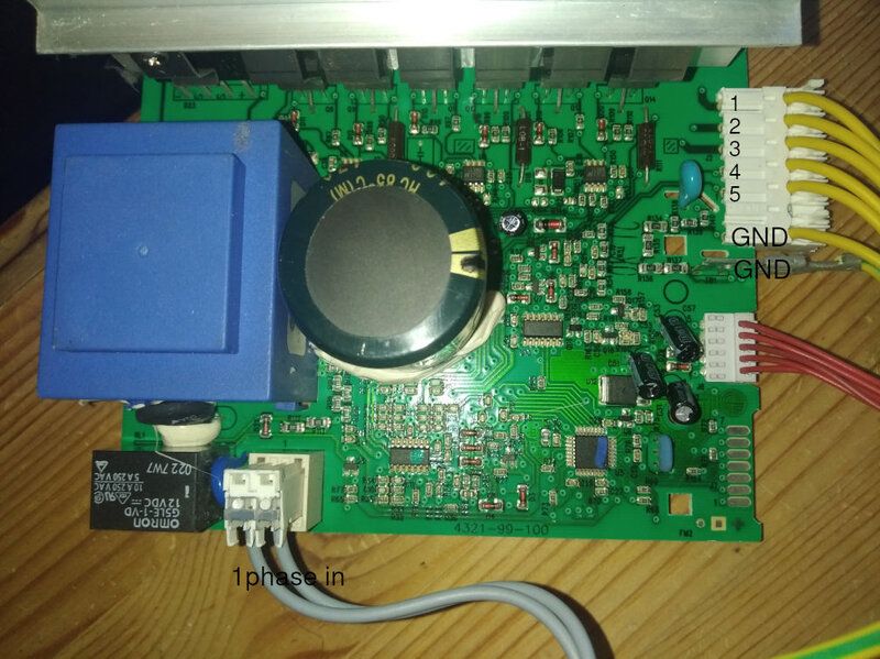

I did order a VFD, thinking it will be able create 3phase from the 1phase solar inverter. But delivery keeps being delayed. So I went to the dump and found a washing machine, thinking I would find a suitable capacitor I could put between two of the leads going down to the pump. However, what I found in the washing machine looks like a VFD. I'm thinking this could be used in a better way than by just using the capacitor (which I think is too large, and may not work as the well is 60m deep.)
The three phase power provided by the power company was 240V between each of the three leads. I think this is what is called a delta configuration. Frequency was 50Hz. Hence that is what I would like to recreate.

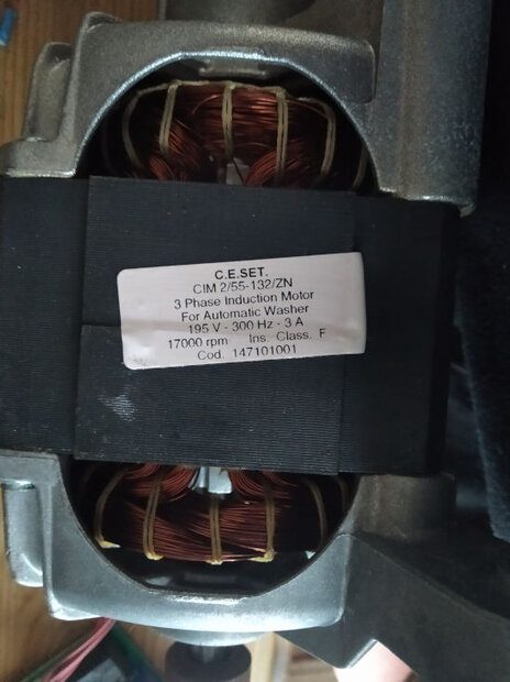

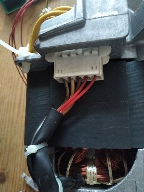

The card I think is a VFD from the washing machine has two grey wires which I'm sure is the 1 phase input. It has a ground wire that connects to the washing machine chassis, it has a connector with 5 red wires which goes to the machine control panel and a connector with 6 yellow wires which goes to the motor. Among the 6 yellow wires there is 5.3ohm (in the motor) between all of the three leads labled 1, 2 and 3. I think these goes to the coils. There is 112ohm between #4 and #5 which goes to the end of the motor. I think this may be a speed sensor. #6 goes to the motor casing, hence I labeled it ground.
img_20220223_163856-jpg.297520
I think this thing will output 3 phase 200V-240V at 50Hz on the yellow cables labled 1,2 and 3, from the input of 1 phase 230V on the grey wires, if I just manage to manipulate the red wires correctly. Does anyone have a clue on how to do this?
The board is labeled 4321-99-100. It comes from a electrolux washing machine.

I don't see anything from the washing machine that would generate enough power for your well motor.

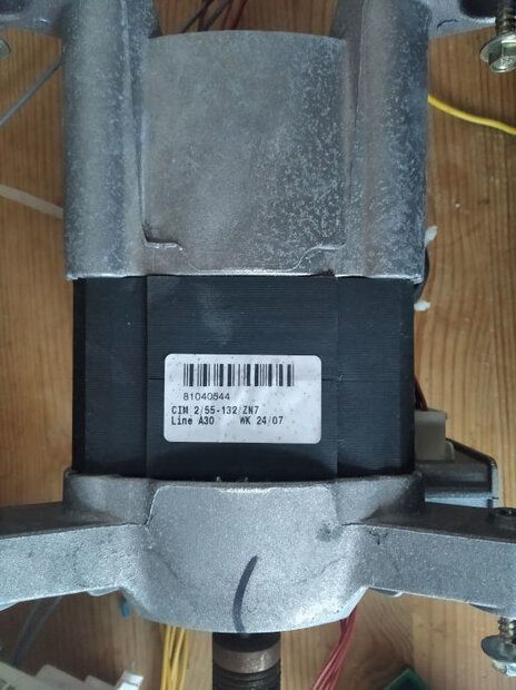

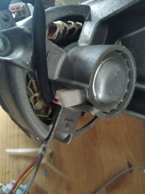

Here are pictures of the washing machine motor:
img_20220223_163723-jpg.297540
img_20220223_163758-jpg.297541
img_20220223_163815-jpg.297542
img_20220223_163827-jpg.297543

But the wash-machine motor is only rated 195V 3A. So it's unlikely that control board would survive long even if you got it working.:(

What frequency is the supply, the motor says 17000 RPM??
195V*3A*1,73 = 1012w. If the board can handle that, it should also be able to handle the 850w of the pump. Besides, if the board provides the well pump with 195V rather than the 241V, the power consumption would probably be down to 690w.
For the well pump: Power line was 50Hz 3phase. Inverter is 50Hz 1 phase. Battery is 48V DC. To run the pump directly on 48V DC would be preferred, but I haven't found any way to do that. (All though at 60m deep, the power loss in cable at 48V might be more than the loss in the inverter. I haven't measured cable size.)
For the washing machine supply is supposed to be 50Hz. As you point out, the washing machine motor is labeled 17000 rpm and 300Hz. I would guess 300Hz would give 18000rpm. Close enough that the numbers makes sense.
