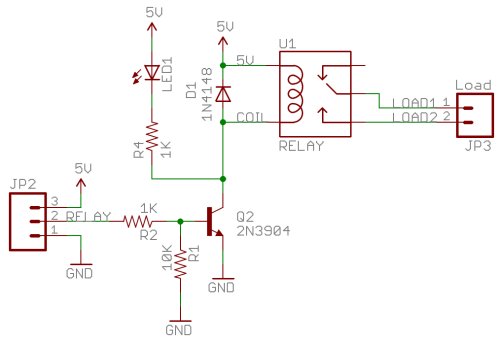

Sorry to say, hevans1944 schematic was a bad example.
This is better schema of relay and it shows 1k input R needed to saturate Q with a 100Ω coil. If LDR cannot drive 1K then NG.
Use this and imagine the coil has a conduction resistance which determines the operating current ..Most schematics are logical, not actual, but the coil is not a resistor rather an inductor with pull on the armature, but has resistance.
Therefore when designing with active switches, a clamp diode across the coil must be added in reverse polarity to the applied voltage so that the transistor does not burn out when switched off from excessive V=Ldi/dt

perhaps a better example .
Here relay is inactive in light.
Dark LDR turns off Q1 which turns On Q2 and relay using N.O. contact.
FET's can also be used with some skills, or even CMOS Schmitt trigger and NPN.
R3 provides positive feedback for hysteresis (aka backlash, deadzone, stable flip flop thresholds). so the relay does not oscillate or chatter at threshold.
http://www.sentex.ca/~mec1995/circ/relayldr.html
