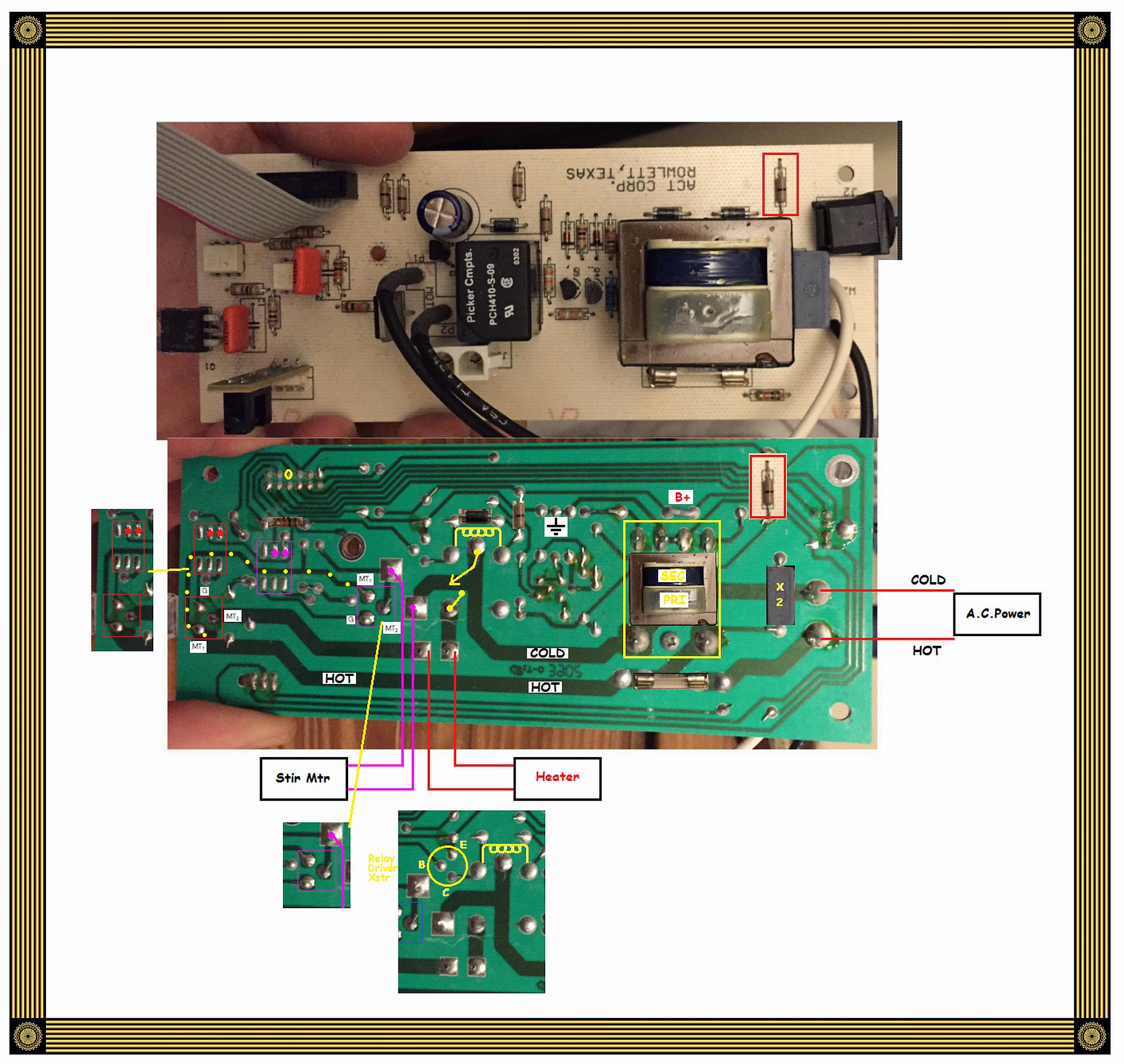

I'm using your good second set of photos, showing both sides of the board paired up . . .which I usually have to prep up myself.
Now I'm only having to do its mark up.
Here are the connections and the power flow path for that board.
Initially, over to right center is the AC input power.
Looks like the fuse is in series in the HOT AC line and is continually putting power to the primary of the units power transformer.
The hefty sized HOT power buss passes further on to the left, and ends at the MT1 terminal of the Triac which controls the units heater element..
Also, a lighter buss off of the HOT AC line passes up and to the right via the YELLOW dotted path, until it connects to the MT1 terminal of the Triac which controls the stir motor.
THIS PATH IS COLOR CODED in RED
Now if the top left Optical Isolator which has 2 RED STARS marking its input terminals is receiving a pulse train from the control board, its secondary section will the let a path be made from the Triac gate to its MT1 terminal, and conduction of AC will be made to the MT2 terminal an AC flow will be fed to the Stir Motor terminals.
THIS PATH IS COLOR CODED in FUCHSIA .
The other situation is for the right of the two optical isolators, which shows 2 Fuchsia Stars marking its input terminals, to be receiving a pulse train from the control board for heating level parameters.
Its secondary section will then let a path be made from the Triacs gate to its MT1 terminals, and conduction of AC will be made to the MT2 terminal and AC supply will be fed to the HEATER terminals,.
One exception on the HEATER path is that the power relay has to be closed, by having 9VDC across its coil. That will then let the heater path to the AC cold buss then be completed.
The relay coil is fed by the relay driver transistor and that transistor gets its activation voltage thru a 1K resistor that is fed from the cabling to the other control PCB at the YELLOW circled terminal.
BTW your black banded unit(s) are Zero ohm "resistors" aka a jumper wire . . . . .but these units are high class . . . . . and are wearing their tuxedos.
Check and see if the stirrer function works initially, if so, then we will move to the HEATER portion.

Wow! Thanks for the effort you put into that. There's so little info out there on these hot plates maybe we can turn this into a definitive guide when this one is up and running.
So I've came back with a fresh mind after the holidays and haven't thoroughly read the posts yet. I have checked the thermistor/thermocouple. If it's a thermistor it is a strange one because at room temp it has infinite resistance. At room temp it should be at a common value 10K ohms, 5K ohms. I've made a spreadsheet to plot the coefficients for a thermistor according to the stein-hart equation.
1/T= a+b(R1/R0)+c(R3/R0)
The insulating wire looks to have been badly burned so maybe there is a short there causing a malfunction? From the burn backwards the thermistor/thermocouple plugs into the LOW voltage control board and appears to have an appropriate resistance value.
Turns out its a thermocouple not a thermistor!

Did you get your 2.5v thru the optoisolator and on the gate?
Haven't done this yet bu with the posting 73's de Edd made I'll be perfectly capable.
Did find the goldmine though apparently these hotplates have a tendency to "runaway" and continue heating causing lab fires which UC Davis has addressed in a concise pdf that may be of use.

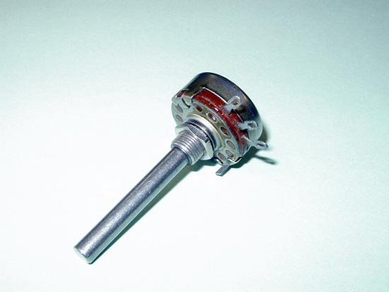

So a few things the first hotplate repaired was 10"x10" second is a 5"X7" hotplate.
I noticed now that the triac is overheating and discoloring the board on the 10"x10". This is a common problem, maybe when I dremeled off the screw that portion acted as a heat sink to dissipate heat?
On the 5x7 the potentiometer for the heat function doesn't spin the axle to reduce the resistance, but when pressed down, forcing the potentiometer to rotate clockwise on the PCB the unit begins heating!

If the 10x10 unit is the first unit concerned with, there are 2 triacs, with the one at the end of the board being bolted to the CAST aluminum /?/ Pot metal housing, which should almost be an infinite heat sinking if silicone grease or heat sink compound was used between the thermo-mechanical interfacing of the triac and cast housing.
BUT with your wording of PCB, it must be the boards central triac, and that is where I would add on a vertical heat sink, or fab up your own custom unit of approx 1/16 in --- 1/8 in aluminum plate , within an available spacing of the upper area., with heat sink paste thermal transfer interlacing also .
On your other unit, find that pots value and replace it with one of these series of "forever" pots . . .built like a battleship on its resistance element and its wiper.
You may have to find it as a new old stock item on e-bay . . . . .
This is an Allen Bradley . . .fired element . . . . .composition pot . . . . . .

The triac overheating is the one mounted on the aluminum housing which I dremeled off (earlier in the thread)...therefore no longer an effective heatsink.
Potentiometer is a specific one (mounting is unique and shaft diameter is important) which is 50k ohms. It's an X type potentiometer and the flatted axle allows for a knob to be mounted. Along with it having 5 pins.

Ahhhhh yes . . . . . I've certainly seen that CTS unit and switch . .with pcb mount bracket and solder terminal tabs . . . . in many years past.
The 37th week of 1997 . . . . . to be specific . . . .for that unit of yours.
If my problem to solve, I would be unsoldering all the connections, lifting the unit, and straightening out the 4 bent over clamping tabs.
That then lets one take the unit apart, to see what is the fault on the bifurcated rotor wiper contacts, to be making loose contact with the resistance element proper.
It could be evaluated then, and possibly mechanically corrected on the spot, or further evaluate, to see if a donor part could be acquired from another mechanically sound CTS unit. . . . .found on the internet /E-bay.
