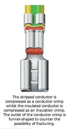

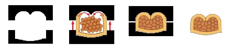

It's trial and examine for proper form and pullout strength on the conductor crimp. The bottom of the die on the tool is curved in a larger radius than your connector would like so you need to select a well that the connector fits into but wedges above the bottom. The connector will be forced down and partially flattened when crimped. The insulation crimp is less critical. The images below show the basic form of a completed F crimp.
Open barrel connectors are made for a specific range of wire and insulation diameter. If you have a mismatch, the wrap wings will be too long or too short, the crimp will be misshapen or broken and/or the wire will not be held securely. Now you see why the "right" tool costs so much.
When you've found the optimal wells for conductor and insulation, mark them with small tape arrows or removeable paint dots until all crimps are completed.

The connector profile is round. The base or bottom die is curved but not as curved as the connector. While it's a given that the crimping operation changes the shape of the top part of the connector; most notably the wings or ears are curled and compressed, it's also true that the bottom of the connector will be somewhat flattened in a non-ideal tool whereas an ideal tool would deform the bottom of the connector less. This is the kind of compromise you make when asking for far less expensive, but serviceable tooling. I have in the past purchased inexpensive dies ($20) for the ratcheting crimpers then ground and polished them to modify the profile to what I needed.
P.S. Since your connectors don't have a flat or semi-flat bottom, you'll need to hold them as securely as possible to prevent rotation during the beginning of the crimping process.
