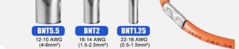

I've recently just got this set of crimping connectors from Ebay <link>.
Have a look at image 2 on that page. I have a Knipex multicrimp tool with a proper tool that put marks just like in the picture and the wire used also fit into that crimp connector.
However, in practice it turns out that the crimping connectors doesn't keep the wire properly, so I can easily pull it out after crimping. Probably the crimping connectors is just too soft a material.
However - I do have a hexagon ferrule crimping tool, using that tool make an almost perfect result. The drawback using that tool however, is that the wire on at least one side of the crimp connector must be fully retractable through the ferrule crimping tool.
That is - as long as one wire can be pulled all the way back through the crimp tool after splicing, all is well and good.
I tested 3 of the replaceable mouth pieces on my Knipex multicrimp tool, but with no great success (material too soft, also when using the mouth piece for wire ferrules).
Any idea what other crimping tool may give the best result for these splicing connectors ?

I would be more inclined to suspect insufficient crimping pressure if you can pull the wires out.

Ok, just found a solution for this.
So I have a small plier that (was never intended for this purpose at phurcase) have the U-shaped press form. And it turns out twisting the wire before insert into the crimp connector AND use this simple pliers so that the cross section take the shape of an "U".
And it actually turns out to hold the wire firmly in place this time.
The pliers I think cost no more than about 7$ (some guessing at the currency rate at the time).
This shows that some times the simplest tools are the best solutions
Found a online image of a very similar pliers
seems the term for this tools are "predator tacle/pistol pliers", "Recon pliers" amongst other terms used on similar pliers.

The image on the website you linked to in post #1 definitely refers to electrical wires, not fishing lines:
