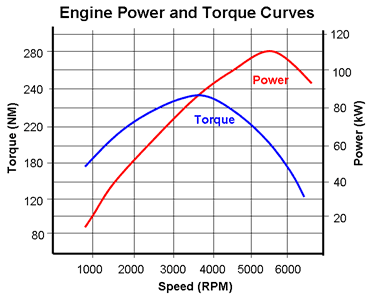

The 7.5 hp from the engine may be available in the optimum operating point only. Much less will be available during idling or at very low or very high speeds. Do you have the hp vs. rpm characteristic of the motor at hand?
Here's an example from another site:
As you can see max power in this example is available at 5500 rpm whereas during idling (1000 rpm) only a fraction of ~ 20% is available. For your motor 20 % translates to 1.5 hp only which is less than the power requirementof the alternator:
Output power Pout = 55 V × 24 V = 1.32 kW equiv. 1.77 hp.
Taking into account losses within the alternator (efficiency around 60 %) the input power to the alternator would have to be at least:
Pin = 1.77 hp / 60 % = 2.95 hp.
If your engine delivers only 1.5 hp during idling, it is no wonder it stalls.
hi harald
its a chinese built engine ( honda ripp off ) no spec details available except the 7.5 hp sticker , as i have said before if i rev the machine to almost max (guesing 3-4 rpm) with the alternator freewheeling then switch battery feed on the engine cuts down but accepts the load and keeps running, i know this is really bad for the alternator but its the only way i can get charging,
