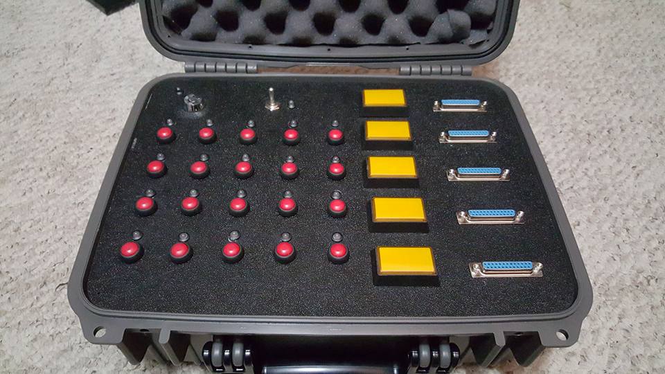

Trying to figure out how to panel mount a db25 connector in a thicker panel form (1/8" abs sheet), seems as though from what I am reading anything thicker than .06" is not going to allow the cable to seat correctly in the cable.
What are my options, maybe grinding down the thickness where the bolts will mount to the panel? Or using a slimmer bolt (if such thing exists)? Any help would be appreciated.

Yeah I guess I need a way to mount the connector in the panel and also still have a way to screw in the cable connection to it. So I was going to use standard screwlock 4-40 bolts, however they would be too high on the mounted connector for the cable connection to be able to use them.

I think my problem is I was going to mount from the inside of the panel, but maybe mounting on the outside is a possibility just like Minder mentioned. (It just wont look as clean since the entire db25 connector will be visible.)

For thin panels I use a Greenlee DB25 punch that is basically intended for external fitting.
For thicker one's I machine the panel and still mount on the outside on my panels, saves problems with mating shells.

Ok, ended up just mounting from the outside, tried several things to get a clean hole and nothing worked. Ended up drilling small holes with the drill and then cleaning them up with the dremel and a router bit, and then doing some filing to finalize the hole. Turned out pretty well. Oh and the project is for a fireworks launcher to be used on the July 4th next year.
Nice job.
Also 1/8" panel is about the maximum you can go when mounting on the inside before you lose integrity of the contact.

Late, but... for 0.090" panels we sometimes use shorter jackscrews. But for 0.125 we usually machine the inside of the panel with a recessed area the size of the entire connector face. With the machined area down to 0.060, the connector fits normally and the outside face is flat and clean.
But mounting the connector on the outside face is more common than you might think, and your assembly looks very professional.
