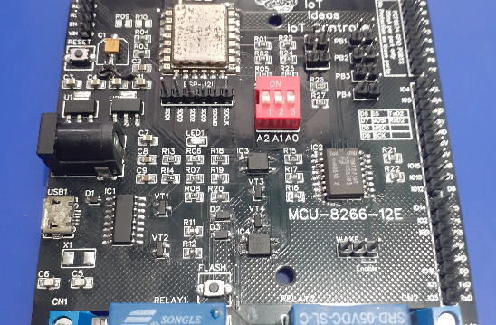

If you have multiple pins assigned to buttons one ADC pin can handle multiple
buttons :
The I2C devices all have different addresses ? Google "I2C pin sharing pdf", lots of help.
Take a look at this : https://chatgpt.com/s/t_6a5a06b732248191b46df15bb8cd4e1c
